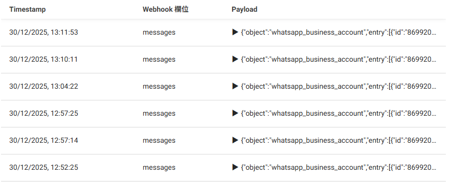

  3. Meta Side: My phone can receive messages from Meta, and Meta’s own logs show that it is successfully receiving the webhook events from my phone (see Image 3).

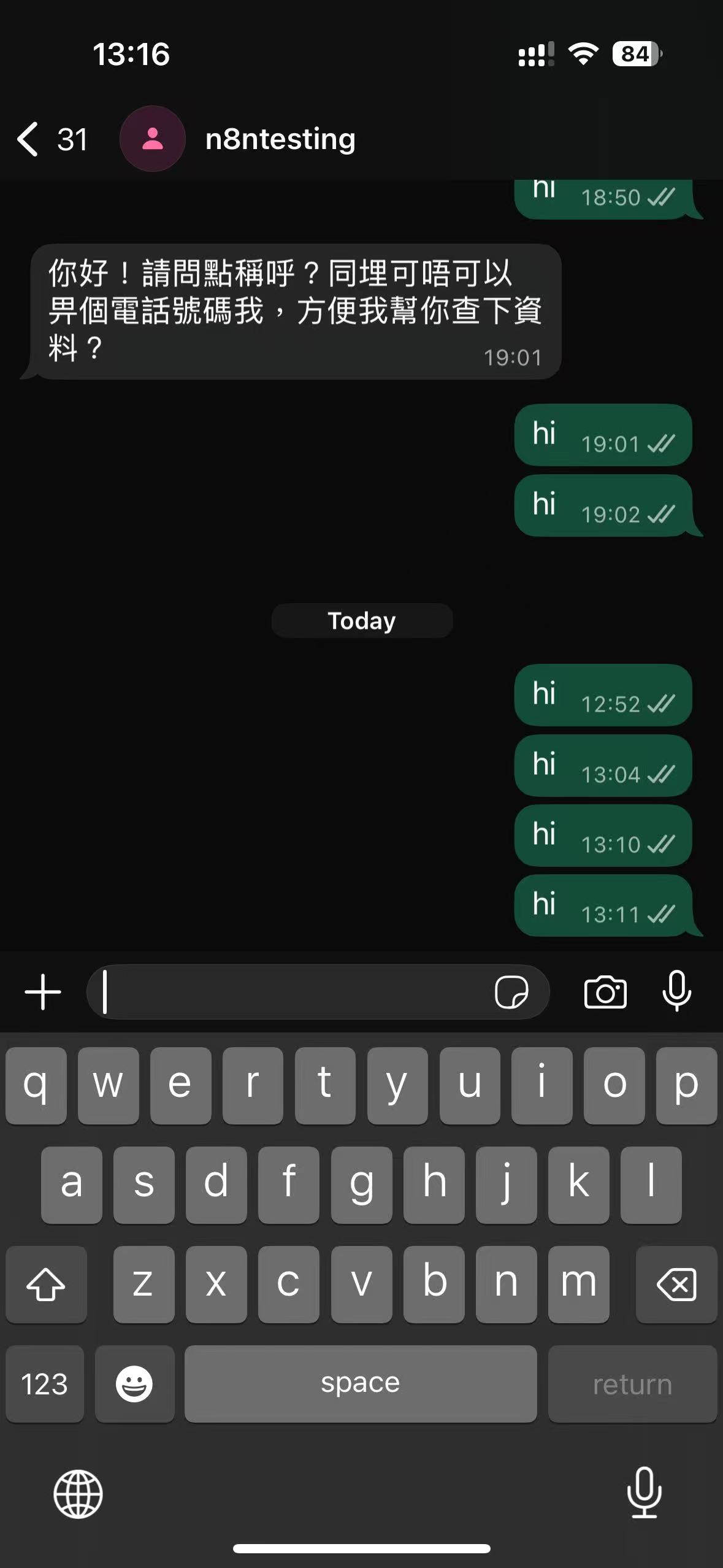

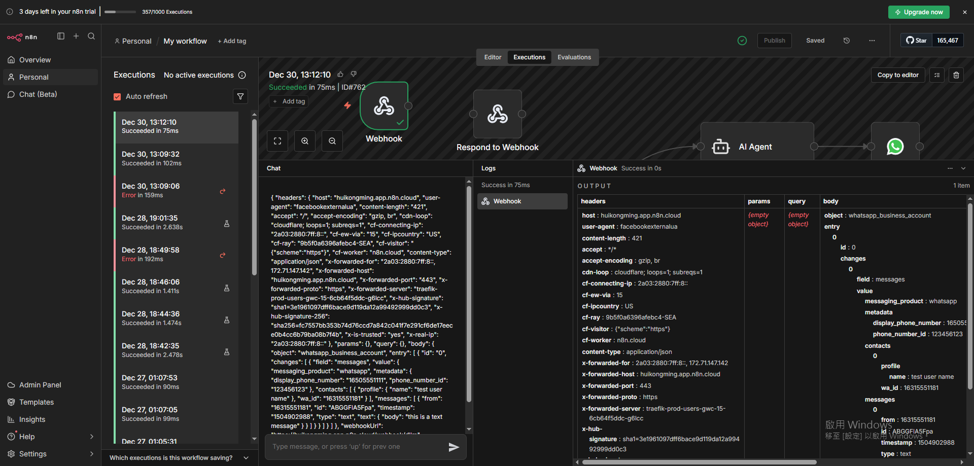

  • Image 1: Shows my execution logs (mostly manual tests or old successful handshakes).

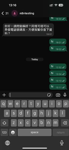

  • Image 2: My WhatsApp chat showing the messages sent.
  • Image 3: Meta’s internal logs showing they are processing the message, but it’s not reaching n8n.

I personally use WhatsApp using twillio services to have more control so I can’t help you in the specific scenario, but are you 100% sure you are using the right endpoint?
did you also try the test url or any other workflow webhook?
when you say you tried manually you mean via postman or similar?
I think it’s it quite impossible they have a block whatsoever in the incoming call
