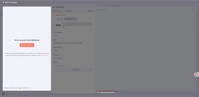

I am a freshman on n8n,i saw someone had done the webhook test success and got sth on the right, but what i got is empty, so why? And i have checked out all my Environment Variables of the n8n-interface and the n8n-worker, so anybody who can tell me where did i do wrong

Yes Sir, the thing is i do use the endpoint URL and added my n8n First Name, it’s like:
https://n8n-interface-pmak.onrender.com/webhook-test/b5400535-d734-4fc0-b401-1edc16f7a367?Name=sc

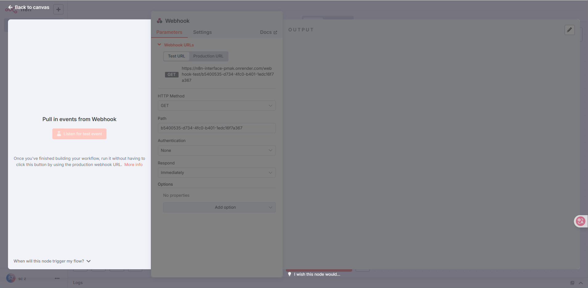

See? and i got this
and still i got nothing on the right of the test page
