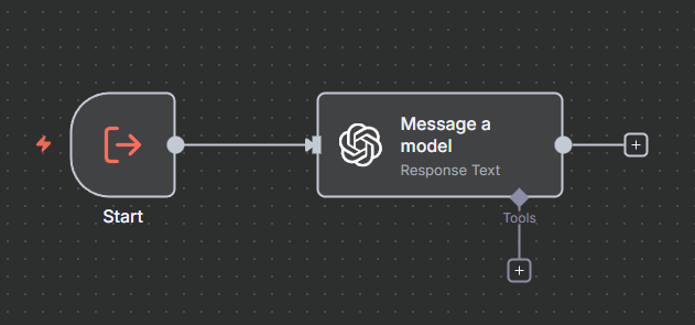

2. Continue using the OpenAI node but use it in a sub-workflow, and set its On Error setting to “Stop Workflow”:
Then, in the main workflow, configure the sub-workflow’s setting On Error > Continue (using error output), then get the execution ID of the sub-workflow, use it to get execution information, and extract the full error object so that you can parse it as desired.
here is an example:
I know it seems like a complicated workaround, but this is what came to mind until there is a simpler built-in feature for this..
