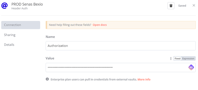

Why http request change my key?
1695612858920_20258B49-8A48-45ad-9993-3FF91321A5CF
Authorization → authorization
How i can fix this?

It causes an error, because the system calling the request is Authorization

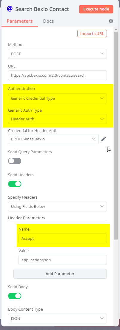

I was able to reproduce it in version 1.8.1. Everything that is passed in the “header parameters” is written in lower case. But in version 1.8.1 there is (also in version 1.7.1 for sure, earlier I don’t know for sure), the possibility of header authentication via n8n directly. Then the credentials are also stored securely and not in a single node.
This works for me then also that in the header is written correctly upper/lower case.
Oh i see Header Parameters Name : Accept → accpet
giống với trường hợp của tôi. Tối khai báo Name :Authorization → authorization
Yes correct, everything entered within the HTTP node under the header parameters is automatically written in lower case.
But if you don’t use the header parameters in the node itself but the “Generic Credental Type” and there the “Header Auth” it works. Then the value is not written in lower case letters
Thank. I have fixed the error

The issue was that certain API’s were case sensitive and only worked correctly if the header auth was submitted correctly case sensitive.
