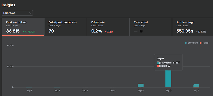

When I check the total number of executions I’ve used last week, the n8n UI shows 38,815, while in my database I see 19,320 (sum of run_index). A few other workflows (maybe 3–5) have also been running, but no matter what, the total never reaches 38,815.

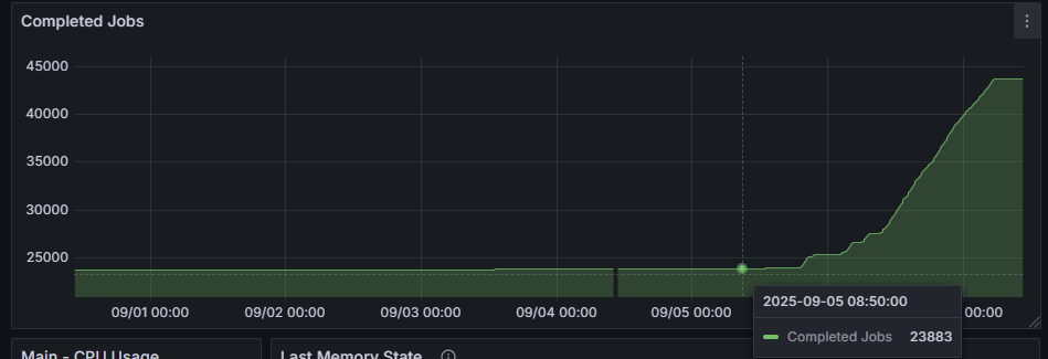

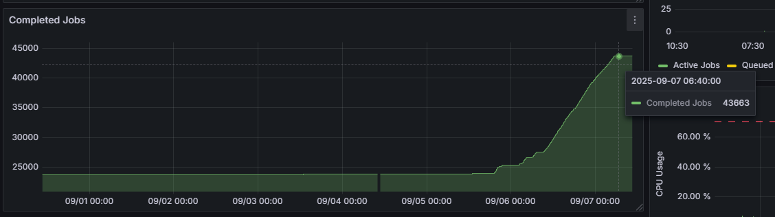

I am using n8n main node metrics to track what is going on, and here is my prometheus query for visualization. (n8n_scaling_mode_queue_jobs_completed ) I have a single environment right now (production).
sum by(environment) (
  last_over_time(
    n8n_scaling_mode_queue_jobs_completed{
      service="n8n",
      service_type="main",
      environment="$environment"
    }[$interval]
Here is the Insight section.
