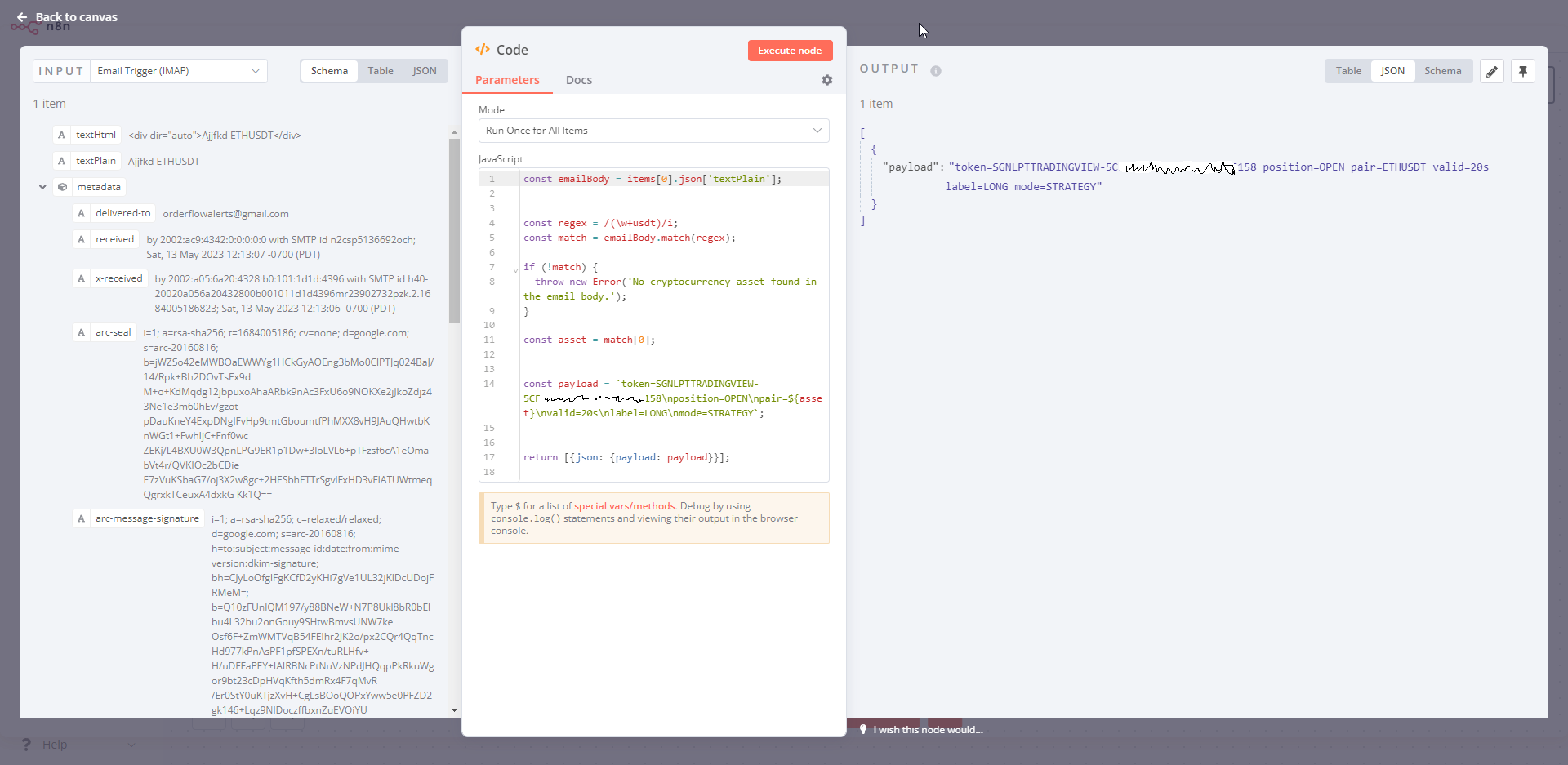

I am reading an email using ‘IMAP’ node and then using ‘code’ node outputting the Payload.(going to attach images for every step) and then adding a ‘HTTP request’ node to send a Post Request.
its not working and outputting empty response. (images attached)
I am going to need a bit more detail on that one, Looking at the node output you have shared the server you are talking to is responding with a 200 header but has no data. I am not sure why the service you are using is not returning anything but it could be that the API just responds with the header status and that is it.

Yes, Looking at the response you have back I would say n8n is processing whatever we are getting. But I also don’t know the API or what it should be sending back so the information I have available to me is very limited.
