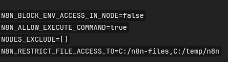

Hi @Touk ! How are you? You can fix this by making your env variable like this!
This should fix it!
Edit - I keep getting a 403 error when typing the env variable so i used a screenshot instead!
