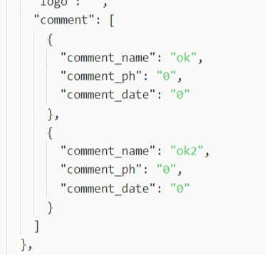

I would like to send data to a repeater (database WP).
Here is the json schema I use to target :
{"acf":{"comment":{"comment_name":"ok"}}}
But it completely overwrites my repeater
to
Hey @delcros_w,
It might be worth checking the ACF API documentation it could be that you need to include the rest of the data in the request as well.
