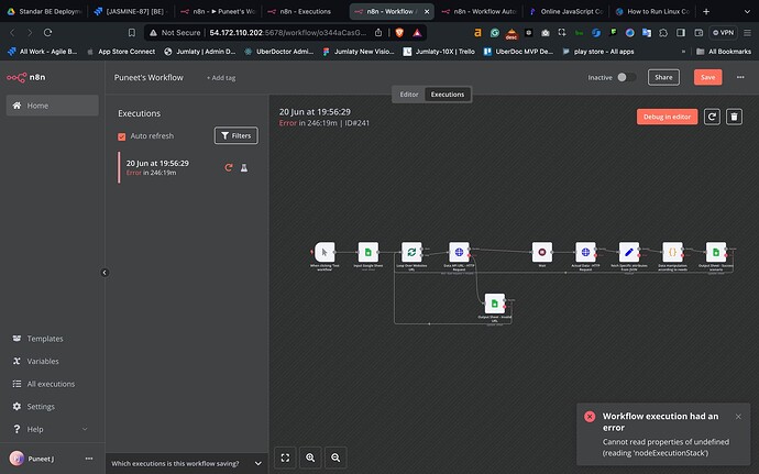

When we run this workflow unexpectedly it stops after some time(ex: 120 mins, 94mins, 238 mins) without giving any details on why it stopped with an error
Below is the screenshot of the Error msg it displays.

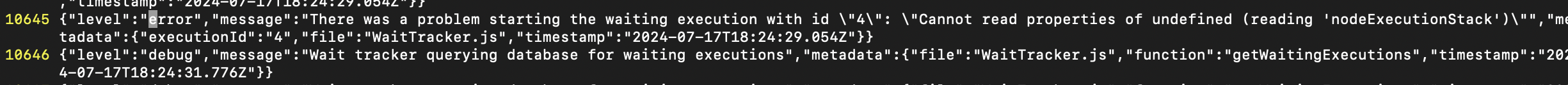

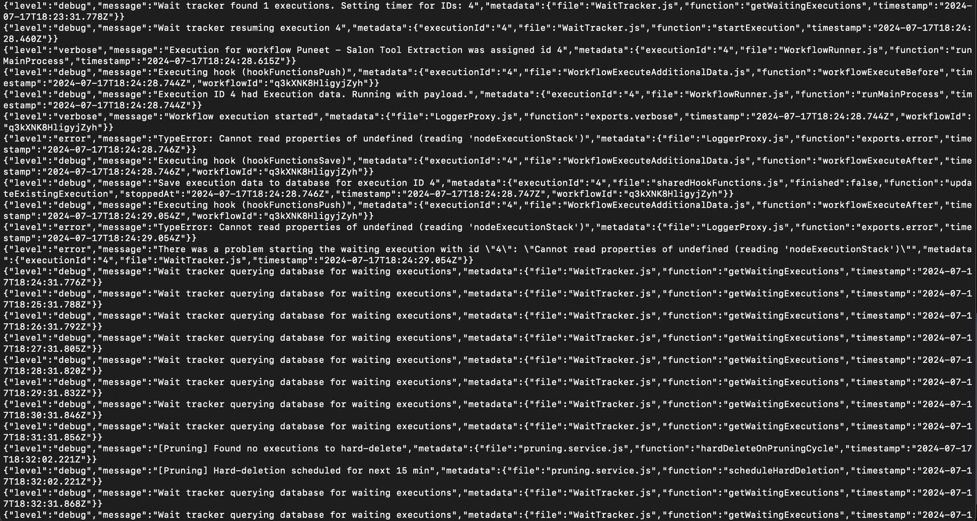

Yeah, I am attaching a few screenshots from n8n.log file which might help us in the scenario.
Thanks in advance.

By the logs, I see that the first image shows that n8n was trying to resume the execution with ID 4 in the very beginning. Then it failed to do so because nodeExecuteionStack was not readable.
Il’l have to ask @Jon to direct this to the rest of the team, n8n is probably having issues saving the execution when it’s put to wait and then when resuming, it fails.
Maybe with this information the rest of the team can address it.
