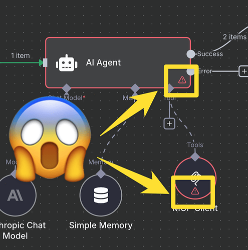

This Agent + MCP is working well now (it didn’t yesterday) :
While this one, which is the one I’m trying to debug and have the pretty same configuration, isn’t working :
I’m so confused !

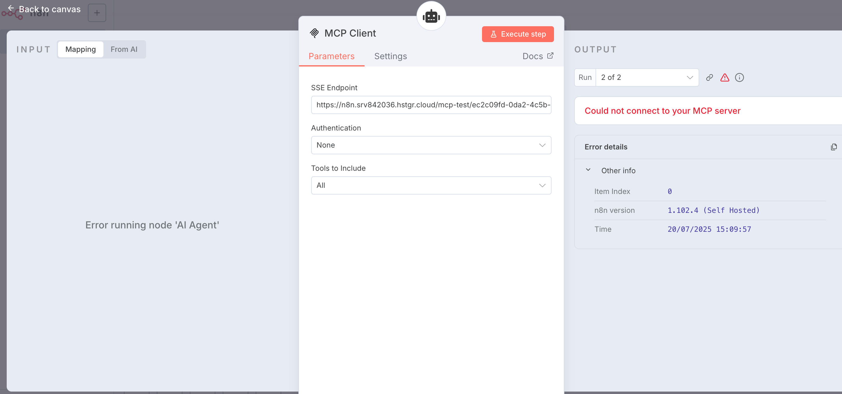

Can you open the MCP Client node when the error is triggered?
Sure, here what I see when opening the MCP Client Node after the error is triggered :

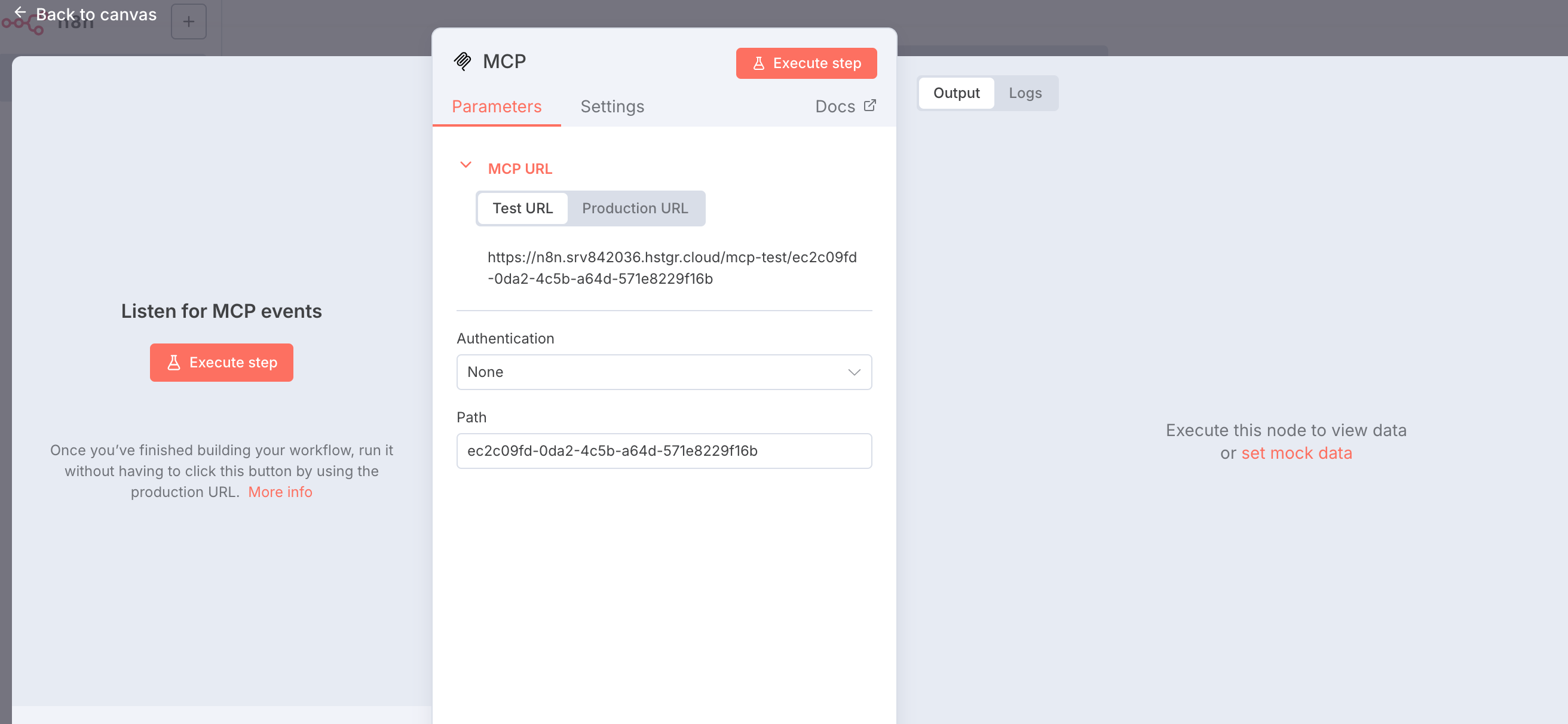

Can you please also add
  • a screenshot from the config screen of the server

Here’s a screenshot from the config screen of the MCP Server

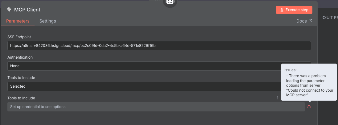

:cross_mark: When running with /mcp/ instead of mcp-test on the same workflow
:cross_mark: When running with /mcp-test/ in test mode on the same workflow
:cross_mark: When running with /mcp/ in a separate workflow
:cross_mark: When running with /mcp-test/ in the separate workflow
