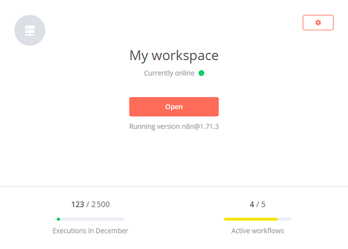

I only have 4 workflows activated on the starter plan, but somehow I can’t have more than 3 active.
Everytime I activate the 4th then one of the other gets deactivated - persistent issue for several days.
I’m on the CLOUD version, 1.71.3 , n8n.

I can see you have upgraded to PRO-1 and you should have up to 15 active workflows now. Do note that each trigger node in the active workflow counts towards an active workflow. That is, if a workflow has 5 triggers it will count as 5 workflows.
