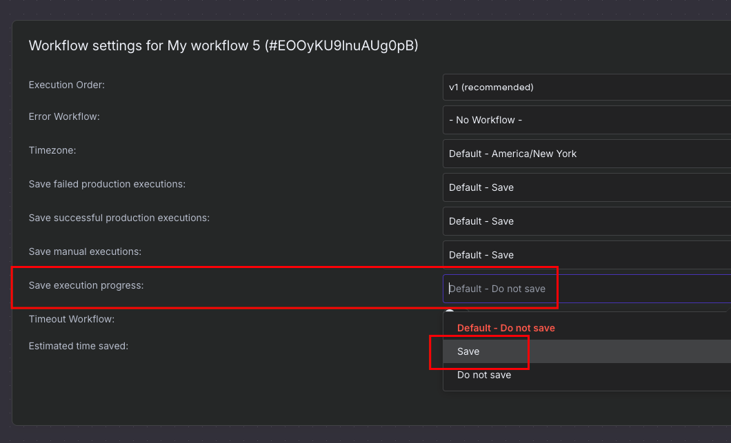

NB: if you want to also get the execution data of a workflow, ensure to toggle this setting in the workflows properties:
