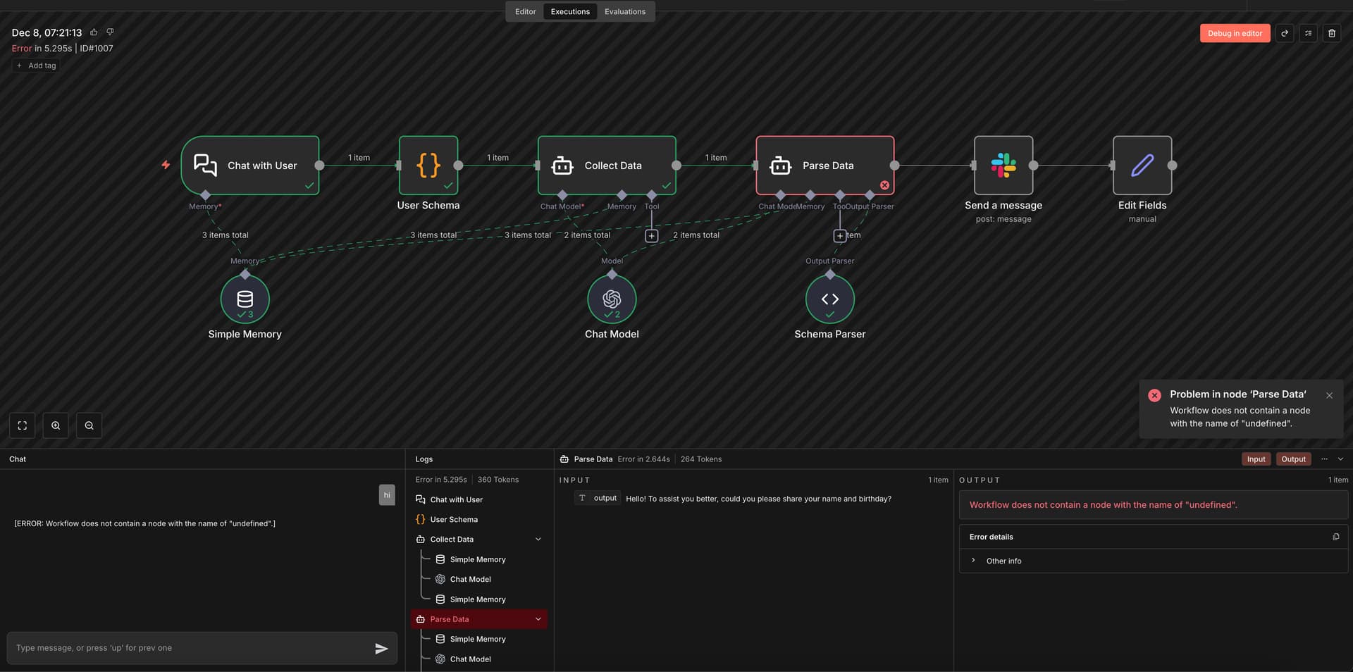

Hi everyone!
I get a strange error when I try to run a workflow from outside.
When tested in the editor, everything works fine.
As soon as I try to check the workflow through the web widget, I get an error.

Hi @romanowlex,
I was able to partially reproduce the issue, as I got some errors with the β€œSchema Parser”,
However surprisingly when I turned off streaming everything worked perfectly!
It looks like there is an issue with streaming or how it’s being handled..
Hi @mohamed3nan,
Indeed, when I turned off the streaming, I also lost the error.
But I would like it to work with her, I don’t understand why this is happening and how to fix it …

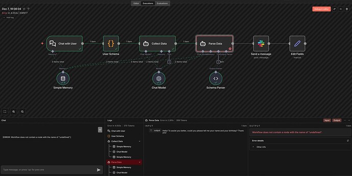

Hi @Sandiyasa,
Yes, I still have an error with enableStreaming
n8n version: 1.121.2, self-hosted
I noticed you’re hitting an error in the Parse Data node when enabling streaming. I believe I’ve encountered this beforeβ€”it seems that when streaming is active, the node loses its reference to the previous User Schema node.
A simple fix that usually works is to β€˜hardcode’ the schema instead of referencing it:
  1. Copy the JSON code from inside your User Schema node.
  2. Open the Parse Data node.
  3. Paste that JSON directly into the Input Schema field (replacing the expression/variable).
This stops the node from trying to β€˜look back’ while streaming. Hope this helps get your workflow running smoothly!

Even if you try with other model?
Tools Agent + openai/gpt-4o-mini fails with but it works when switching to openai/gpt-4o?
Eager to try myself when I get to PC ..
I tried it with the model gpt-4o and it worked )
