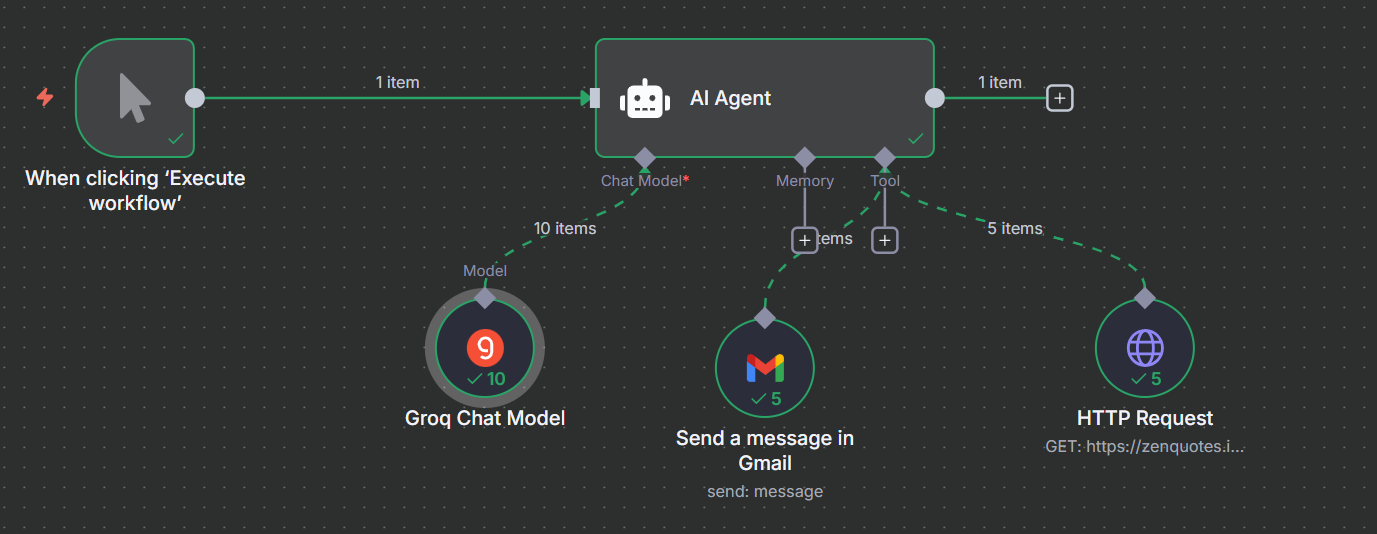

I have created this workflow that uses grog chat model and within that i am using deepseek. Sometimes it runs 5 times and sometimes even more. What could be the reason? Ideally it should run only one time.

When the AI Agent doesn’t achieve it’s purpose it can get stuck in a loop. That’s a dog chasing its’ tail.
What you can do;
  • Check every output of the AI Agent of every run to see what is the AI missing.
  • Change the settings of tools to ‘Execute Once’ and see if it works.

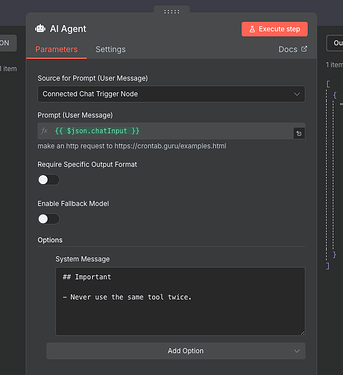

  • Or explain to the AI Agent how it should work in the system prompt.
Note: Making the system prompt longer is one way to make the AI perfect. But at the cost of tokens.
