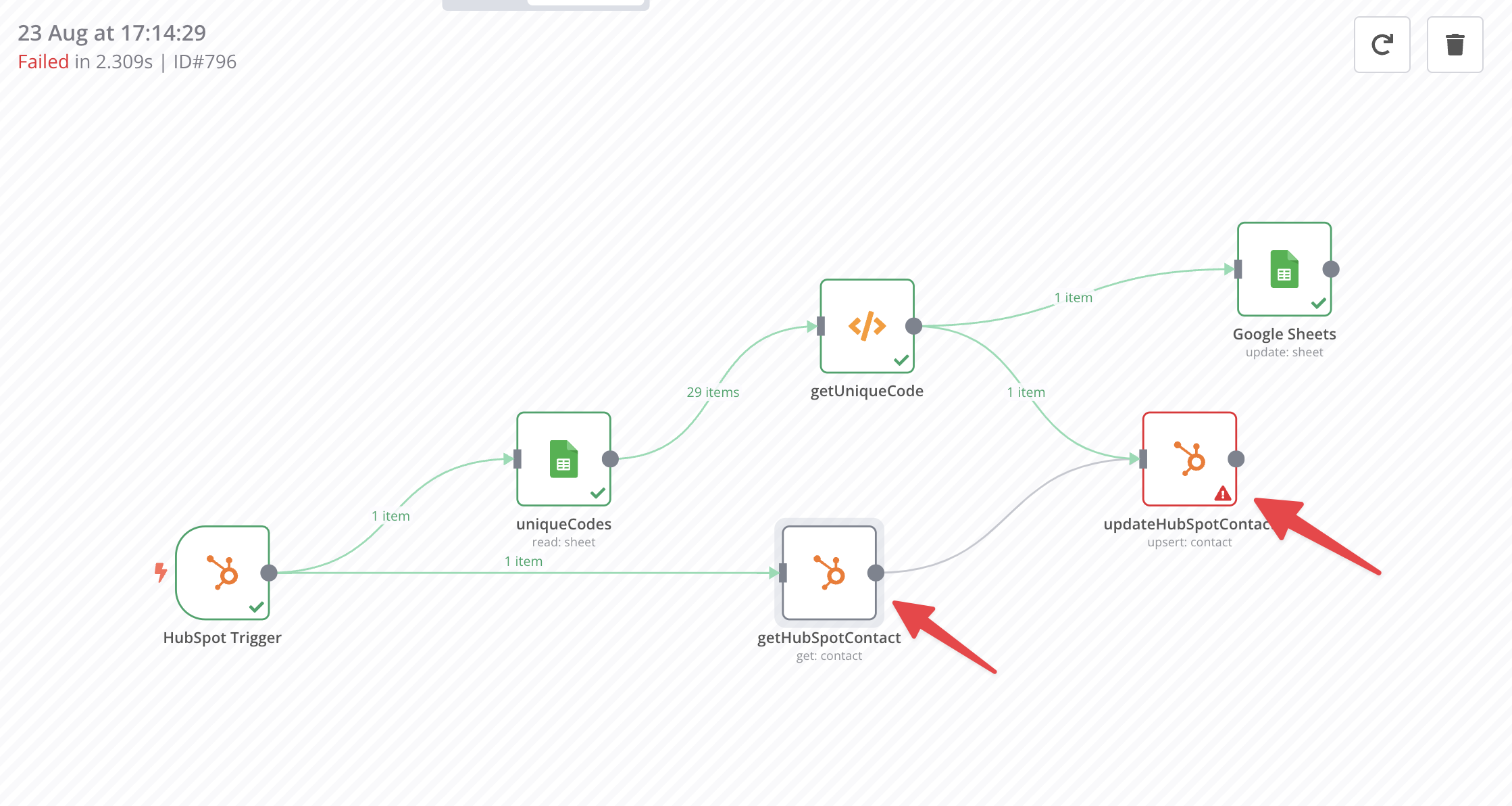

For whatever reason, the getHubspotContact doesn’t run…if I manually run it, it works fine, so it’s not an error. It just never starts. Is it somehow not getting the message to start because I have two things coming out of the trigger?
Note that the getHubspotContact node is definitely getting data if I check it out under executions.

Taking a guess you’re on v1+ and you’re using the new workflow execution order which is depth first.
In this case your update contact node runs from the first branch (and errors) before the get contact node can run.
You can either set continue on fail for the update contact node, or move the get contact node higher than uniqueCodes so it runs first.

OH…I see what you mean. Because that updateHubspotContact is situated higher up on the page, it’s run first before getHubspot contact. I wasn’t aware that’s the way it works! Thanks for clearing that up!
I would probably use a Merge here.
