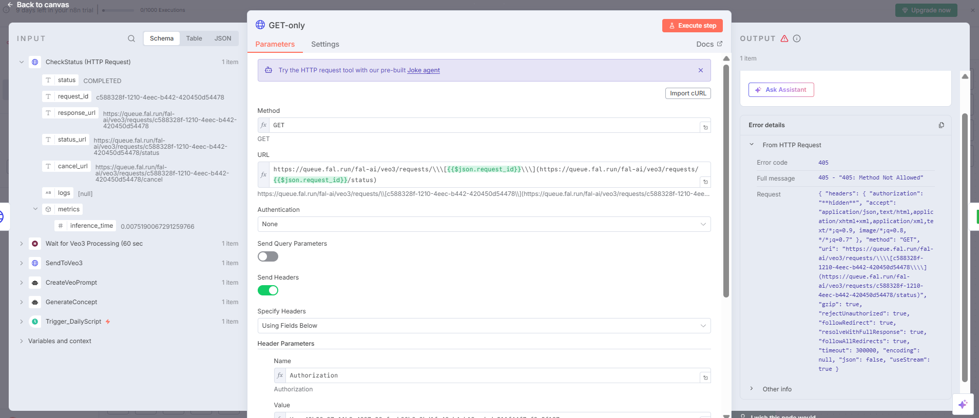

Workflow fails with a 405 Method Not Allowed error, even though the method is set to GET
I’m trying to integrate the FAL Veo3 API into an n8n cloud workflow to automatically generate videos.
The POST request (SendToVeo3) to https://queue.fal.run/fal-ai/veo3 works and returns both request_id and response_url correctly.
However, when using a subsequent HTTP Request (GET) node to poll the /response endpoint and retrieve the generated video, the workflow fails with a 405 Method Not Allowed error, even though the method is set to GET.
I’ve confirmed the URL format, authentication header, and method are correct, but the endpoint keeps returning a 405 or sometimes 422 depending on how the query string is formatted.

Please share your workflow/screenshots/recording
Summary
Node: SendToVeo3 → returns request_id + response_url
Node: BuildResponseURL1 → builds URL https://queue.fal.run/fal-ai/veo3/requests/{{$json.request_id}}/response?wait=6s
Node: GET-only → HTTP Request (method = GET) using that URL
Auth: Header Auth or manual Authorization header (Key <api_key>)
No body/query parameters
Screenshot examples attached:
GET-only node configuration
Execution output showing 405 error

Looking at the documentation of FAL you might be using the wrong URL indeed. I understand the process to be as follows:
Hi thanks for your response. are you saying i should update my call status url endpoint to https://queue.fal.run/fal-ai/veo3/requests/{{$json.request_id}}/status ? if thats the case i get a seperat error: Invalid URL: https://queue.fal.run/fal-ai/veo3/requests/2ed27666-7b51-47ab-9171-32706ce845f8/status. URL must start with “http” or “https”.

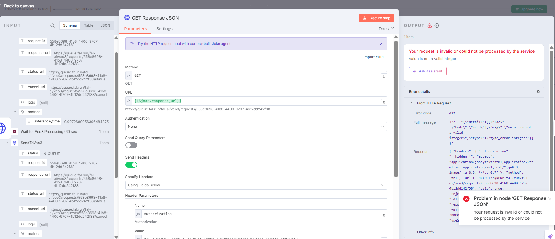

this is my current work flow + the error i encounter within my get node

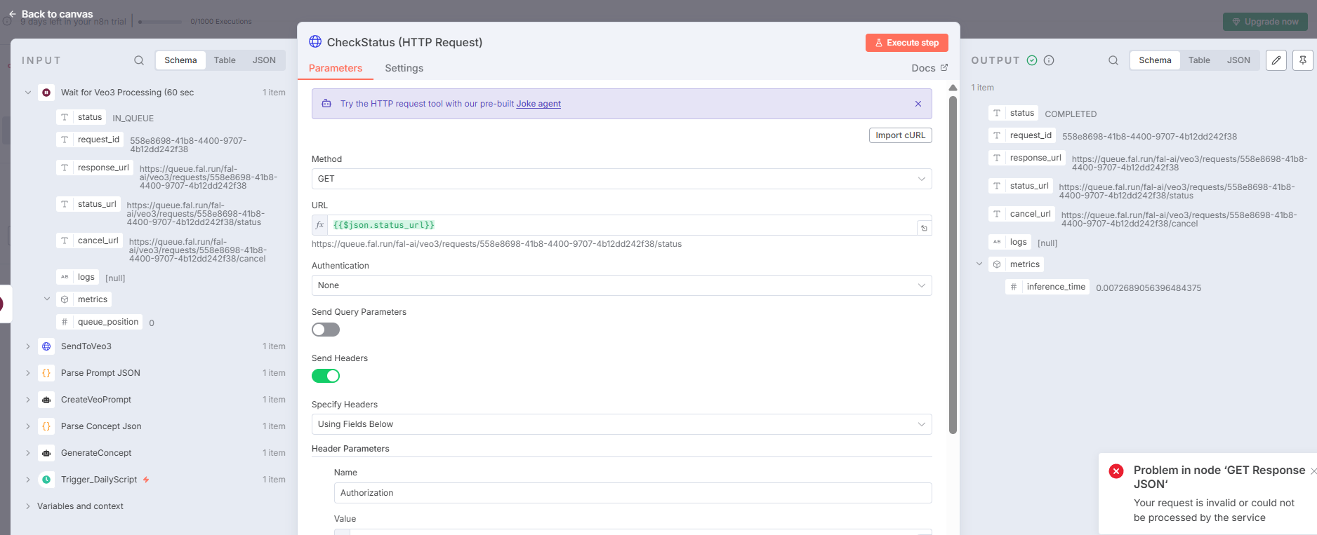

That’s really helpful, thanks! The URL from the second screenshot looks pretty strange, you can just use the variable “response_url” from the previous step.
Can you please try to replace the URL field with this?
{{ $json.response_url }}
That should do the trick.
i tried the above endpoint and this is what i get. its driving me mad! i cant see whats wrong here.
heres my check status call - looks ok and works fine
We’ll get there, no worries :wink:
The “check status” call looks good, so let’s try to figure out why the “get results” call fails. I can’t see any issues with how you call it, and the error that you get doesn’t really make sense here: it says that you’re sending data in a wrong way in the “body”, which is a field that can not be present on a “GET” request that you are sending. It sounds more like a bug on the side of FAL.
