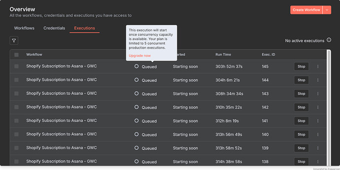

Workflow not working - showing congruency error not sure how to fix it
I’m currently seeing an error that says the execution will start when the concurrency capacity is available.
This has been going on for a couple of days. The run time is a couple of hundred hours.
I checked yesterday, and it was the same issue. I’m not sure what I can do to get it working again.
Hi @Aghori_X
Every time you trigger an execution of the workflow now, it will end up in the Queue. You can only run 5 workflow simultaneously in your plan. If the workflow takes around 300h each, it is around 13 days - so only every 13 days a slot in the queue frees up.
Start by cleaning the queue - stop the pending jobs.
Then check the workflow, run time of over 300h is very long. Consider adjusting it, maybe splitting into smaller chunks to make it executable.
Hope this helps,
Gosia
