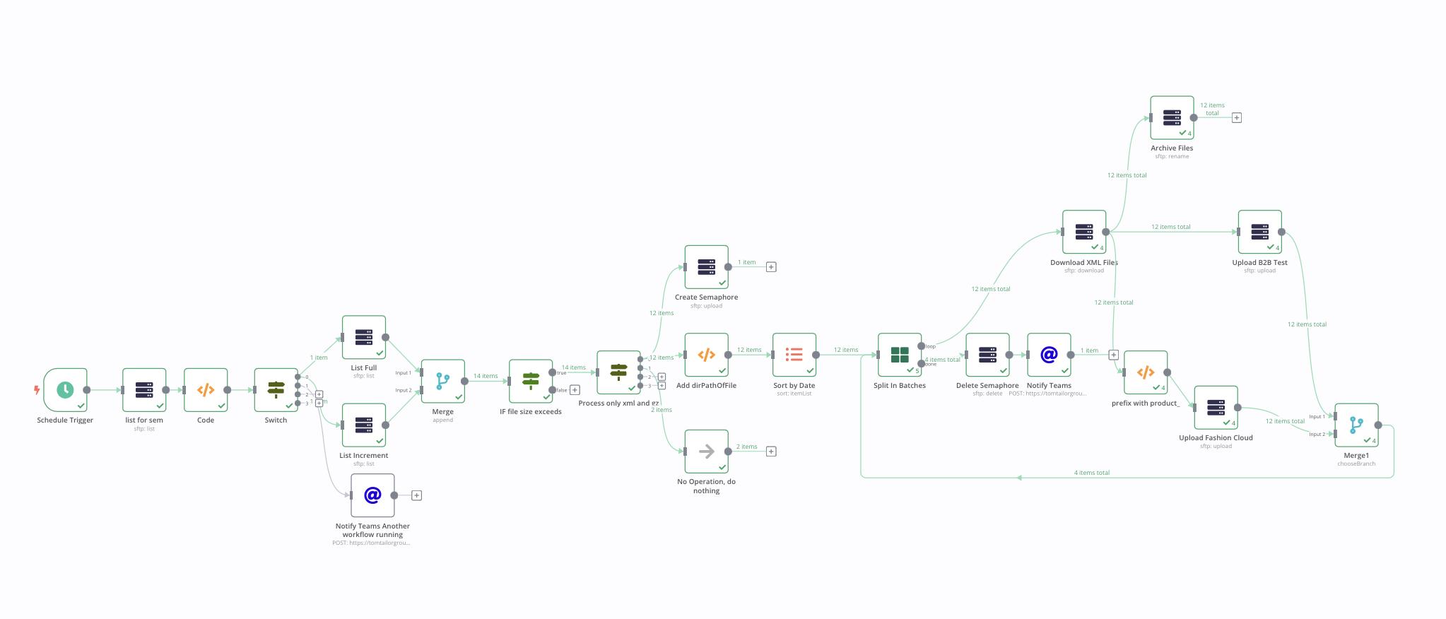

We have a workflow that runs every 30 mins, it runs when I click on Execute but fails on scheduling without any error message

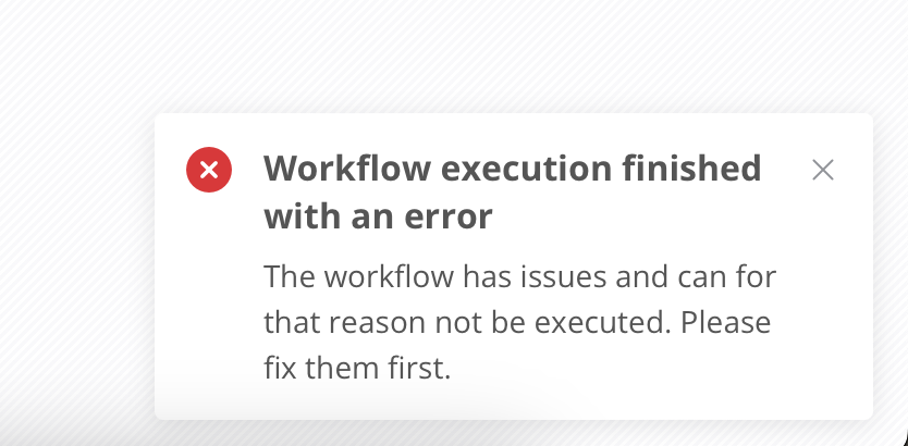

running from failed execution throws below
Problem with retry
Cannot read properties of undefined (reading ‘nodeExecutionStack’)
Adding merge after upload fashion cloud and b2b causing the error, if we give the node to split node loop without merge nodes after done are not running.

It looks like you have missed a bit if the template, Can you tell us which version of n8n you are running and how it is deployed. The workflow you have shared also doesn’t match the screenshot.

Only on adding merge node after upload b2b and fashion cloud throws error, but when the merge node is deleted and directly giving input from B2B and fashion cloud to split in batch running the workflow but we are not getting teams notification on completion

Its running fine when I click execute workflow manually but when it runs on schedule it throws Failed without any error message

It is possible that it is related to your workflow but I would still like to know if you are in queue mode, When you are on queue mode the workers would trigger the workflow not the main instance like when you press the run now button so knowing this would help rule out any issues there which is why we ask :slight_smile:
Quick edit… The new message you have shared would also have been handy to have in the original post along with the rest of the template we request.

workflow runs without any error on schedule, but here teams notifications isn’t working after spilt in batch is done

Looking at the workflow again that merge node does seem oddly placed and I am surprised it works at all as it is waiting for both inputs before moving on so I would expect that to possibly cause some issues but if it is ok from execute in theory on a schedule it would be ok as well.
As you are in queue mode it could be worth making sure all of your workers are on the same n8n version to rule out anything odd there, It might even be worth checking the worker logs to see if they show any errors.
Thanks worker node was never updated and still had 0.214 version where the deployment had the latest, updating the worker to latest fixed the error.

Only there, The bit that was interesting was just the use of it as it typically needs both inputs to fire off but one of them is coming from a loop so I am surprised it was looping correctly.
I suspect though the issue may be that the workflow you are using has a newer version of that node or one of the others and that is causing it to fail on the schedule without running.
Here both will have input because all the files input in “split in batch” to upload in both B2B and fashion cloud and the loop continues, once the last batch ran and done in “split in batch” we are sending teams notification
