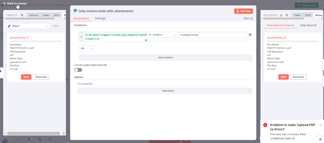

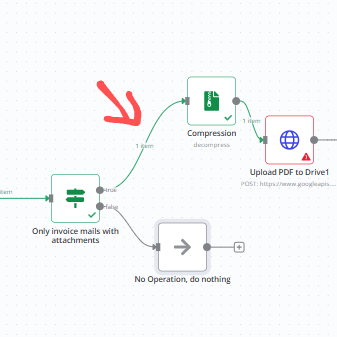

I have an IF node before the compress node. Can I use this existing IF node, or do I need to create a new one? I’m unsure how to set up the conditions to read both the PDF files and the compressed files.
You should be able to remove the “Do Nothing” node and connect the other false if statement path to the Upload PDF to Drive. You may need to make slight changes in the upload node to reference one or the other correctly tho. Not sure.

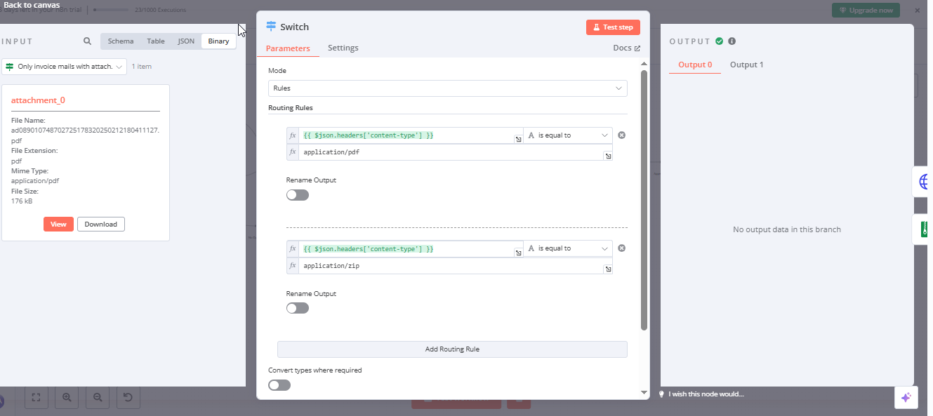

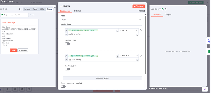

You can also use the SWITCH node instead, if you want to filter by more than 2 file types.
Hello @solomon,
I get an error in the PDF to Drive Node.
Switch Node:
Work Flow:

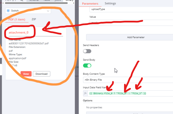

Upload PDF to Drive
Are you using the correct binary field name?
attachment_0
Hi @solomon, I hope you are doing well. I made some changes, but it is not passing the PDF to the next node as it should. There is no output, and there is no error message.
You have to use $binary to get the MIME type

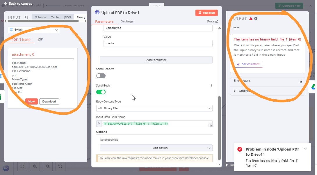

Hello @solomon, thank you, now I get this in the next node “The item has no binary field ‘file_1’ [item 0]”
You’re missing the name again, @daniel30
remember: The binary field name is always in that orange/red color above the file.
