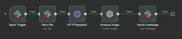

My Workflow is quite simple. A Screenshot is sent to a slack channel. The workflow sends the image to gpt to convert it to text in a certain format I want and it sends back the text in the same slack channel. When I test (execute workflow) it works perfectly. But once I made the workflow active, it no longer notices the trigger (sending a file to the channel) Would love some input on this.

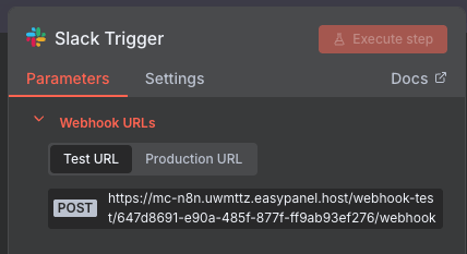

Double check if you are using the correct production URL. Active workflows use production URL of webhooks(refer to image).
Thank you so much @Mookie_Lian That was the issue, I was using the Test URL. Thanks so much!!
