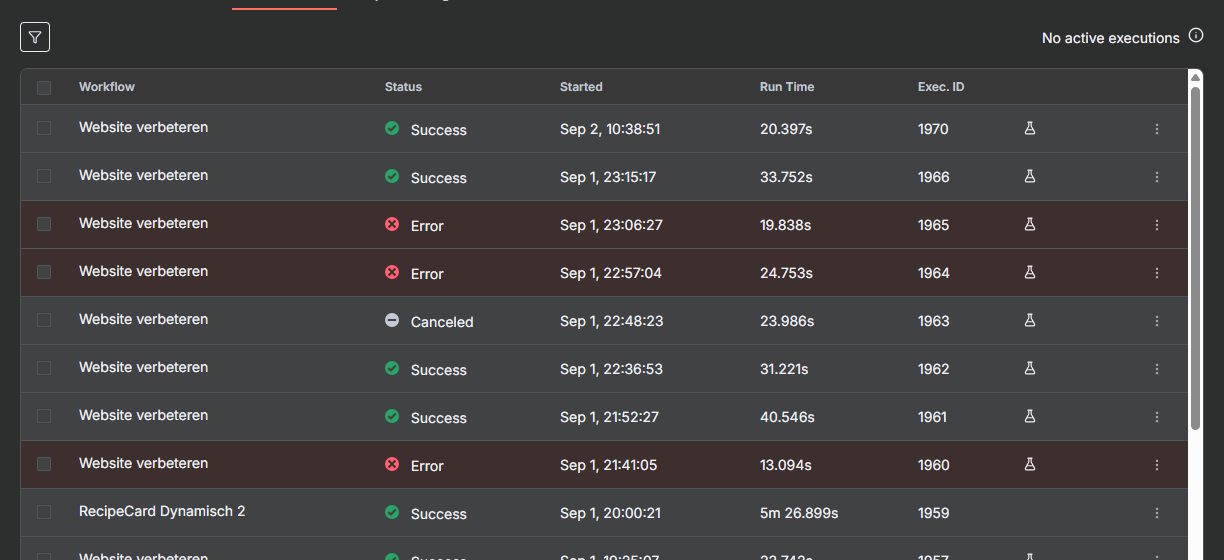

Last time it triggered was 20:00:21 and then no more triggers happened. Nothing has changed.

I’ve put the trigger on every 20 minutes and now two work instead of just one… could there be a too long of a pause? I’m so confused.
Screenshot below is the one not triggering. It’s a paid cloud instance. My Timezone is GMT +1 (but this shouldn’t matter if it should be triggered every 3 hours right?)
