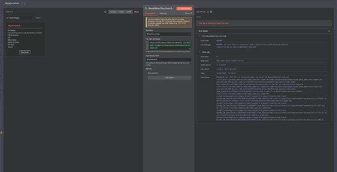

I am trying to write a file to a folder on my desktop.
I get the error shown in the screenshot
Please, how can I resolve this, or must I store it on the N8N Docker volume I created
if that is the only option, how do I go about doing that as well

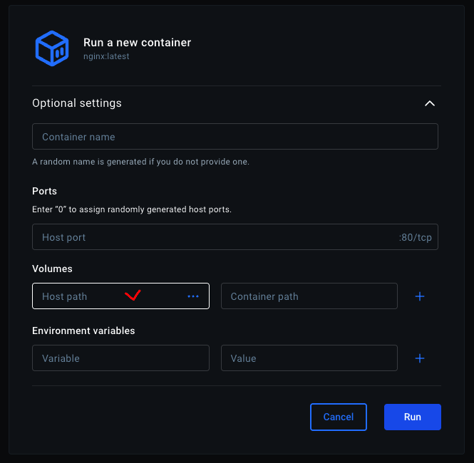

The folder can be mounted with a named volume or bind mount. What you probably want is the latter.
To mount the bind mount, you need to specify the folder as one of the volumes in your docker compose definition if you are using one. If not, and you are using docker run command, you would specify two paths (host path and container path) with the -v flag, finally if you are running a docker desktop, you would choose the folder to mount and the destination here:
If you show us how you attempted to mount your folder, we can try to hypothesize further.
