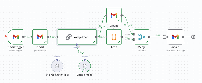

And this is what the workflow looks like:
I’ve found that sometimes it can still give an incorrect empty JSON object when the incoming email is too complicated for the llama model to understand, however, i figured that with the model I’m using, it is good enough.
I’ve just noticed the last node is not connected. That was simply for testing purposes. I’ve ran it with that node connected and it works fine.
