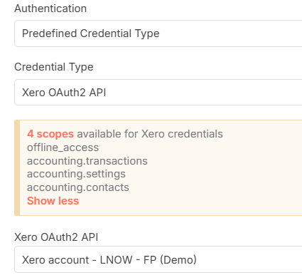

Limited scope workaround: Switching from Authentication: Generic Credential Type, Generic Auth Type: OAuth2 API to Credential Type: Xero OAuth2 API
Another issue arises, the accounting.attachments scope is missing from the Xero OAuth.
@Jon any suggestions / update on this?
