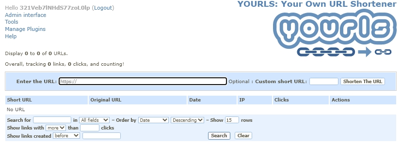

Yourls node works with an error
Hi!
If checked separately on just one Yourls node, it seems to work fine.
But if I use this node in the workflow, I get the error “URL already exists in database”.
ERROR: Bad request - please check your parameters
https://docs.google.com/spreadsheets/d/1HCNrhoHzjP5yh[...] already exists in database (short URL: 1.1144.ru/20) although no such URL exists in the database Yourls
{"message":"400 - {\"status\":\"fail\",\"code\":\"error:url\",\"message\":\"https://docs.google.com/spreadsheets/d/1HCNrho6wH5yh[...] already exists in database (short URL: 1.1144.ru/20)\",\"errorCode\":\"400\",\"statusCode\":\"400\",\"url\":{\"keyword\":\"20\",\"url\":\"https://docs.google.com/spreadsheets/d/1HCNpaLXfr9pDyOy9w28j8/edit#gid=1902344499\",\"title\":\"Ошибки публикации в zzap - Google Таблицы\",\"date\":\"2022-09-07 19:36:48\",\"ip\":\"17\",\"clicks\":\"0\"},\"title\":\"Ошибки публикации в zzap - Google Таблицы\",\"shorturl\":\"http://144.ru/20\"}","name":"Error","stack":"Error: Request failed with status code 400\n    at createError (/usr/local/lib/node_modules/n8n/node_modules/axios/lib/core/createError.js:16:15)\n    at settle (/usr/local/lib/node_modules/n8n/node_modules/axios/lib/core/settle.js:17:12)\n    at IncomingMessage.handleStreamEnd (/usr/local/lib/node_modules/n8n/node_modules/axios/lib/adapters/http.js:269:11)\n    at IncomingMessage.emit (node:events:525:35)\n    at endReadableNT (node:internal/streams/readable:1358:12)\n    at processTicksAndRejections (node:internal/process/task_queues:83:21)"}

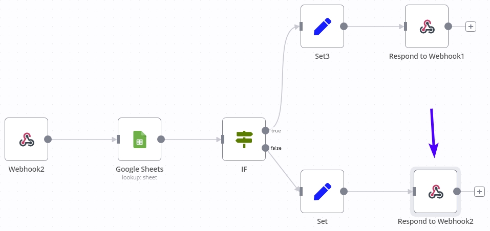

Is it meant to always shorten the URL of the Google Sheet?
Hey @Jon
No, here is the correct workflow:
Hey @Mikhail,
When you get the error is the Google Sheet node only outputting one item?
@Jon yes, that’s right - 1 item .

While they are answering my question, I wanted to ask about the Respond to Webhook node:
If there are Cyrillic characters in the link - the workflow gives an error: Bad Gateway
the link:
https://docs.google.com/forms/d/e/1FAIpQLe4YWCMeMTwi8GuEP_RDMlZsTBJfhE25Q/viewform?usp=pp_url&entry.122621695=105424&entry.1246242845=Облицовка%20Audi%20A8%20(D4)%20III%20рестайлинг%20(2013–2018)&entry.308542603=250
Is there any way to resolve this issue so that everything works correctly?
Thank you!
Does the same redirect work with other urls ok? The url itself seems to be ok so I am not sure why it would be throwing a gateway timeout.
All links of this kind with Cyrillic characters or russian words like “Облицовка”, “рестайлинг”, etc will not work in that workflow. But they work on their own if you manually insert them into the browser or click on them.
This happens precisely because they have Cyrillic characters.
I thought there was a way in n8n that works in a similar way as in a browser,
when you manually copy or paste something, it converts ( punycode-converter ) all the links.
For example, here’s a website:
https://объясняем.рф
and if you go to it and copy the link address from your browser, you get this:
https://xn--90aivcdt6dxbc.xn--p1ai/
It is the same address, just Cyrillic characters converted to Latin.
Hey @Mikhail,
You are not using a full domain with cyrillic characters though so a full conversion likely wouldn’t be needed like that. Instead what you would need to do is encode the URI so that it can be understood so the URL you have would go from…
https://docs.google.com/forms/d/e/1FAIpQLSfh005B4KhktaUllQe4YWCMeMTwi8GuEP_RDMlZsTBJfhE25Q/viewform?usp=pp_url&entry.122621695=105424&entry.1246242845=Облицовка Audiv A8 (D4) III рестайлинг (2013–2018)&entry.308542603=250
to
https://docs.google.com/forms/d/e/1FAIpQLSfh005B4KhktaUllQe4YWCMeMTwi8GuEP_RDMlZsTBJfhE25Q/viewform?usp=pp_url&entry.122621695=105424&entry.1246242845=%D0%9E%D0%B1%D0%BB%D0%B8%D1%86%D0%BE%D0%B2%D0%BA%D0%B0%20Audiv%20A8%20(D4)%20III%20%D1%80%D0%B5%D1%81%D1%82%D0%B0%D0%B9%D0%BB%D0%B8%D0%BD%D0%B3%20(2013%E2%80%932018)&entry.308542603=250
You can do this using the workflow below which is working in the testing I have done using your form url.
Yes, everything works perfectly. :+1: Now I don’t need the Yourls node.
