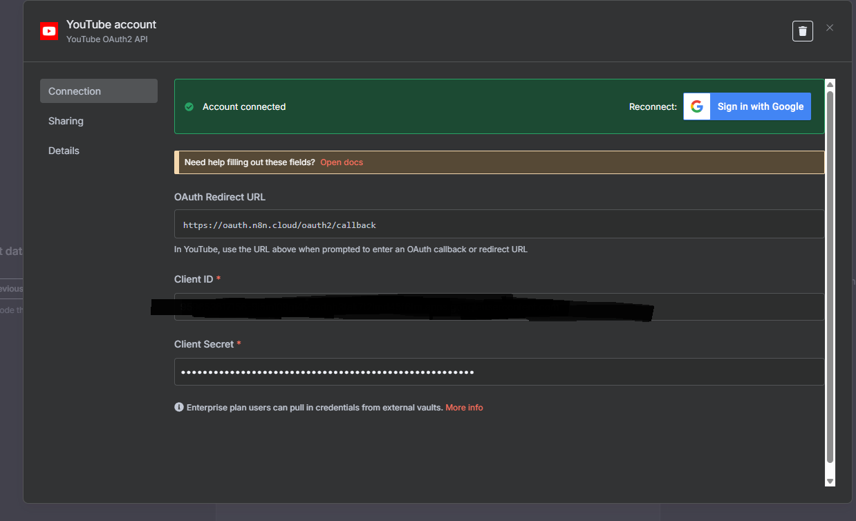

I’m trying to add a YouTube node to my workflow, and I successfully created the OAuth2 Client ID. I enter everything properly, and it says “Account connected” with a green checkmark in the YouTube node under connection.

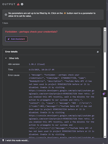

However, when I execute the node, it says “Forbidden - perhaps check your credentials?”
Help! I can’t get much done without this node working.

Here are the credentials looking A-OK to me:
Here’s the error:

OK, I figured out what was wrong with the credentials. I didn’t have the YouTube API enabled in my project in Google Cloud Console.
