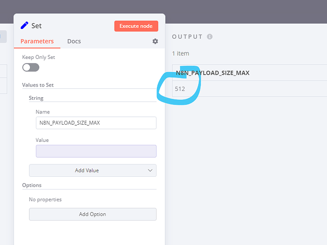

  1. how to know this method is working or not because i am afraid try to upload videos from yesterday
You can read any environment variable through an expression such as {{ $env["N8N_PAYLOAD_SIZE_MAX"] }}. Running the below workflow in an n8n instance started using N8N_PAYLOAD_SIZE_MAX=512 npx n8n@latest should return a value of 512:
Just keep in mind that the exact way of setting environment variables will depend on how you have deployed n8n. So far it is not clear to me how that’s happening.
Now This is what i am getting. before i am going to execute one more thing that is where should i run this command as a user or as root and is this the proper command i shown below ?
