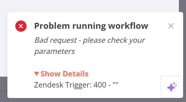

Zendesk Trigger node is throwing error. For the first time after creation of node it successfully listens to the trigger but after first time it starts throwing error.
Problem running workflow "Bad request - please check your parameters Show Details Zendesk Trigger: 400 - “”
I checked the network tab and saw that the the condition object in parameters is being sent as empty object even though i selected option “all” with desired values of conditions.

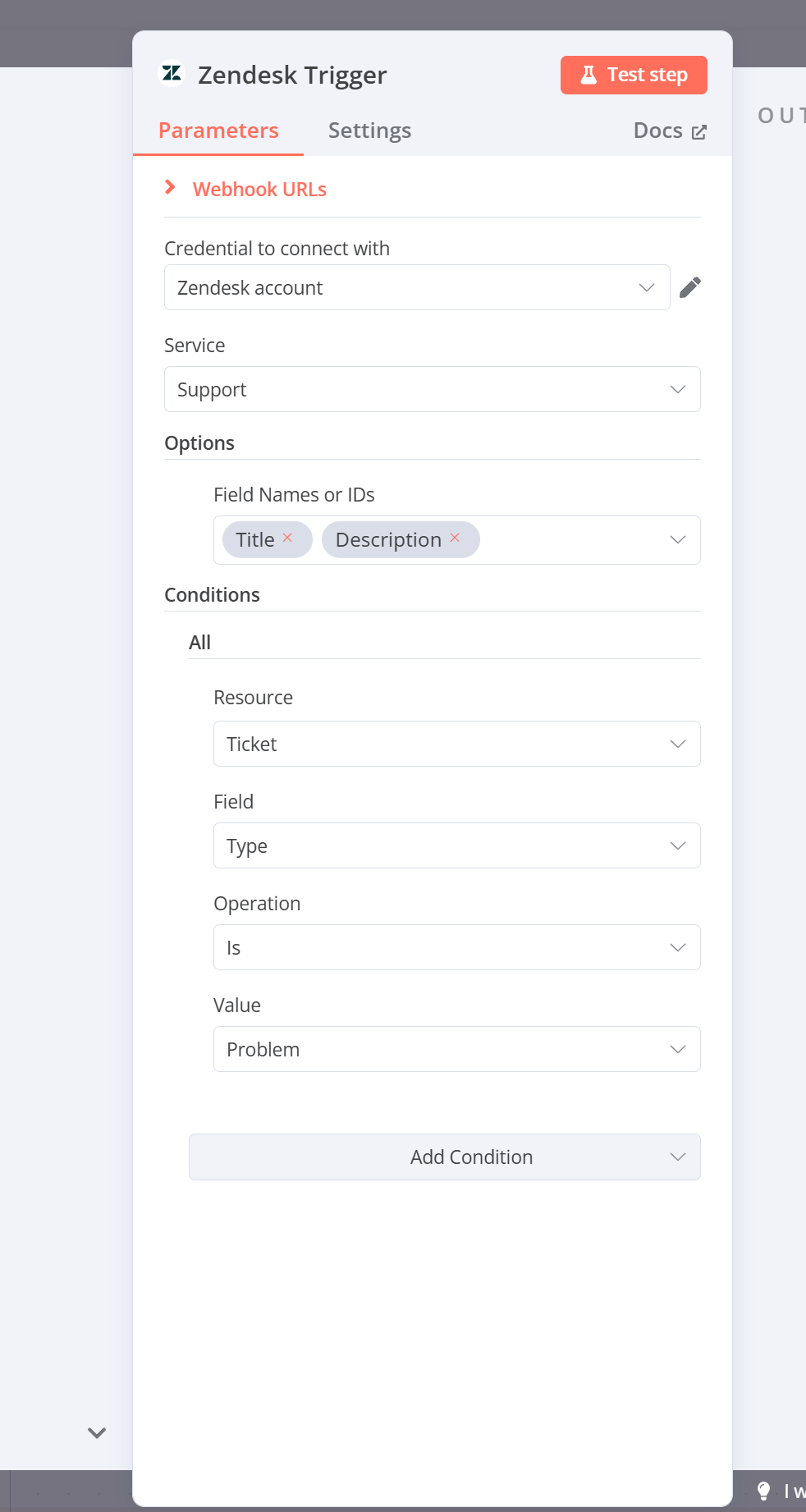

Here’s the json
this is what I see
Were you able to subscribe to that webhook url via zendesk?
What URL does it show? Is it a localhost:5678? That will not work, it needs to be a publicly accessible domain.
I am experiencing the same issue. We have a workflow that has been running for months, yesterday it stopped being triggered on new Zendesk tickets.
I checked the Zendesk webhook history, and it showed me that n8n started returning a 404 for the webhook URL (again, the workflow hasn’t been edited in months).
The 404 error mentioned something about the workflow being inactive, so I checked it, it was active. I tried to deactivate and then reactivate it, hoping toggling would reset its status, and now I cannot activate it. I get an error, simply “400 -” with no explanation.
I also cannot test execute the workflow, whenever start listening for a test trigger, I get the same “400 -” error right away.
