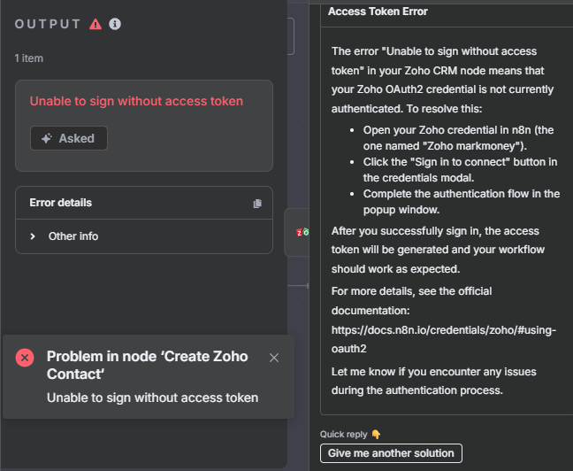

could you be more precise as what do you mean by the environment not working? i really need this to be sorted out and i really never understood why it never wanted to work for me
it gives me this solution that ive tried but no progress has been made in having this workflow function
By environment I simply meant something related to your specific setup (which is rather different from mine, where I run from the self-hosted n8n). I’d assume your tried to remove and setup the authentication (credentials for Zoho) from scratch? The error itself suggests there is a problem with authentication, so maybe trying to re-issue the OAuth app and then re-create the credentials in n8n too could help?..
I think is a lost cause, because what youve stated i have tried and once again made no signifcant progress. do you think i should communicate with a specialist in zoho api’s?
I mean that definitely wouldn’t hurt, although I don’t think they’d be able to help much tbh, because from what the error says (Unable to sign without access token), it sounds like n8n doesn’t have the access token to attach to the api request (or it is expired, or cleared). Since I am running the same authorization without any issues, I don’t believe the issue is with zoho authorization or token server, although I could be wrong.
Just to make sure, when you created the client on the Zoho API portal, you used Server Type, right?
yes i used server type with the correct client ID and secret as well as the correct redirect url, like i said no progress
