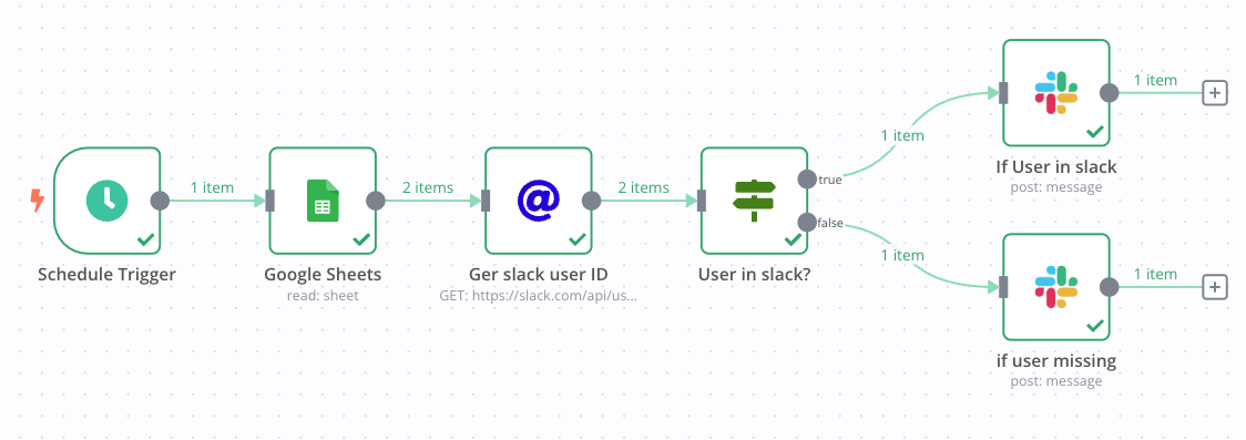

In that case I would have a follow up question, as this haven’t resolved that issue.
I’m basically slowly trying to move our old zappier nightmare to this.
It says n8n handles multiple outputs automatically and this looks to be correct.
But at the same time “some” of the data I’m getting is wrong.
Slack message is sent based on if users has a Slack profile or not. This part works correctly.
But then message contains data from Google sheet and that is no longer matched correctly, only 1st instance is always used.
So “user in slack” runs twice for 2 rows from sheet.
But ending stage always takes 1st row from sheet.
