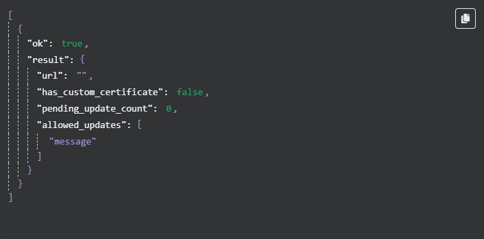

It will be set automatically within the trigger node. However, you can check if it was set correctly with the HTTP Request node and your bot token. Change the url part <your_bot_token> with actual token
Thank you for the instruction.
I checked both my telegram bots. One has a webhook url, the second doesn’t.

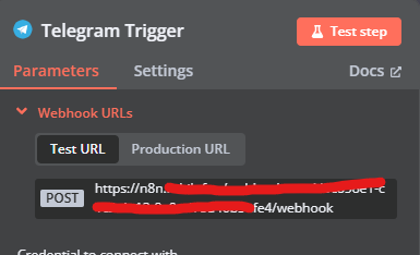

On my n8n side, the telegram trigger has a test webhook (it’s greyed out, and can’t be changed)

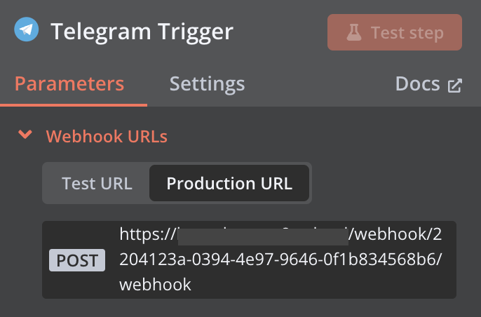

You can see the production url by clicking on the Production URL button

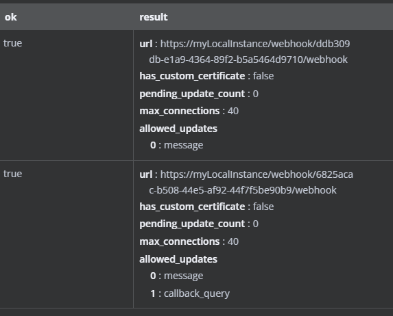

What is the output of the HTTP node for both bots if you enable both workflows with the Telegram triggers?
I’ve tested on my self-hosted instance and there were no issues.
Both workflows are active now.
Both requests are returning the same webhook above.
However, now my agent 1 workflow is not triggering. Agent 2 (the one that I just activated) is triggering.
