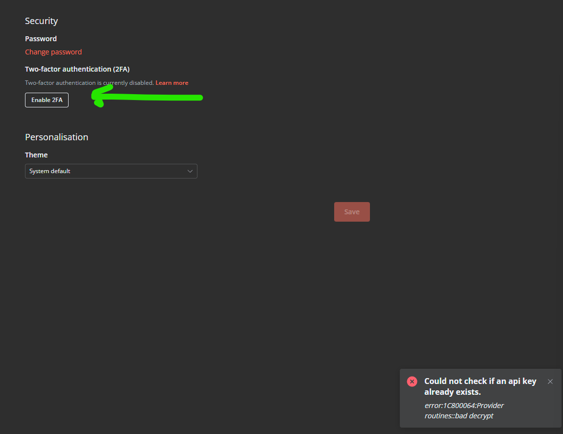

Everything works fine (credentials are active and workflows run) but I am not able to enable the 2FA again.

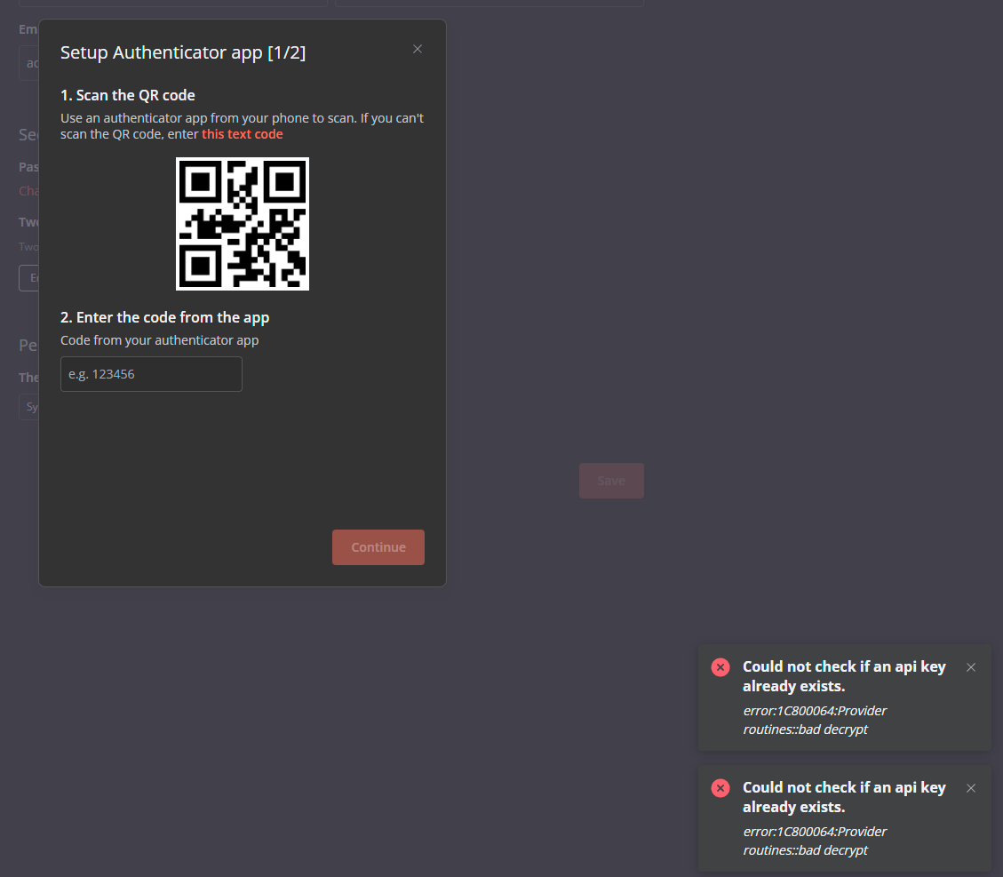

I.e. I can see the QR code but my Google Authenticator app does not scan it.
Could not check if an api key already exists.
error:1C800064:Provider routines::bad decrypt

The 2FA is not enabled now. I have tried to stop and start again but the error is still there, and if I try to enable it I get a QR code that does not seem valid for Google Authenticator.
If I press ‘this text code’ , in theory the code is copied to clipboard, but the clipboard is empty.
