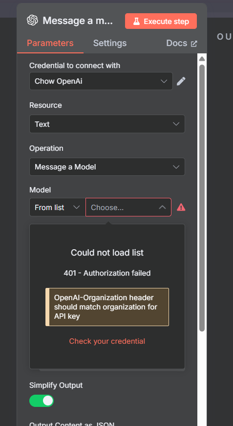

401 - Authorization failed OpenAI-Organization header should match organization for API key

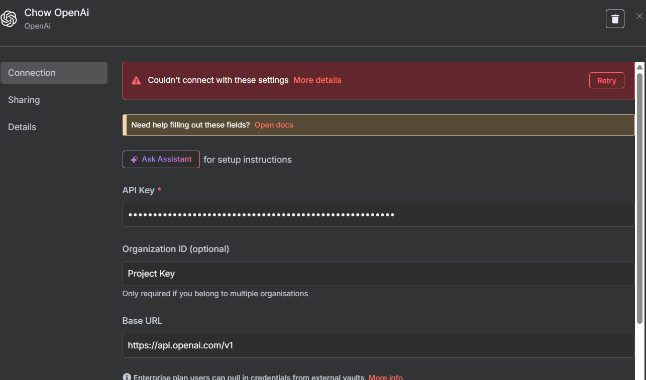

I try using the OpenAi Message A Model node and when i connect to my OpenAi Credential, i could not load any openAi model from the model list. When i go to check on my OpenAi credential settings, there is a connection error but then i can confirm the API key is correct. I have even tried re-create the new API key several times but it failed the same.

Does your API key belong to an organization or is this for a personal account? If there is no organization, remove the “Project Key” text from the Organization ID field in the credentials.
thanks @jabbson and it works like a charm right after I’ve removed it. What a silly mistake..
