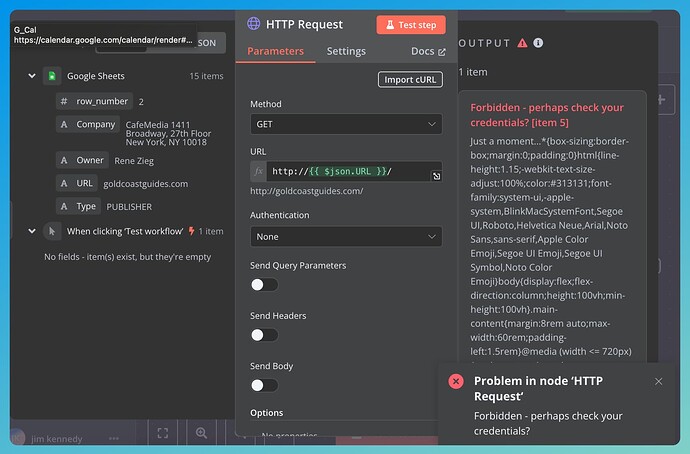

I just want to read the home page info and send it to openai to determine the topic or niche of the website from the home page - I have look and can not seen to find any answers - should i pass a User_Agent in the header - if some how do i do that? Thanks Jim

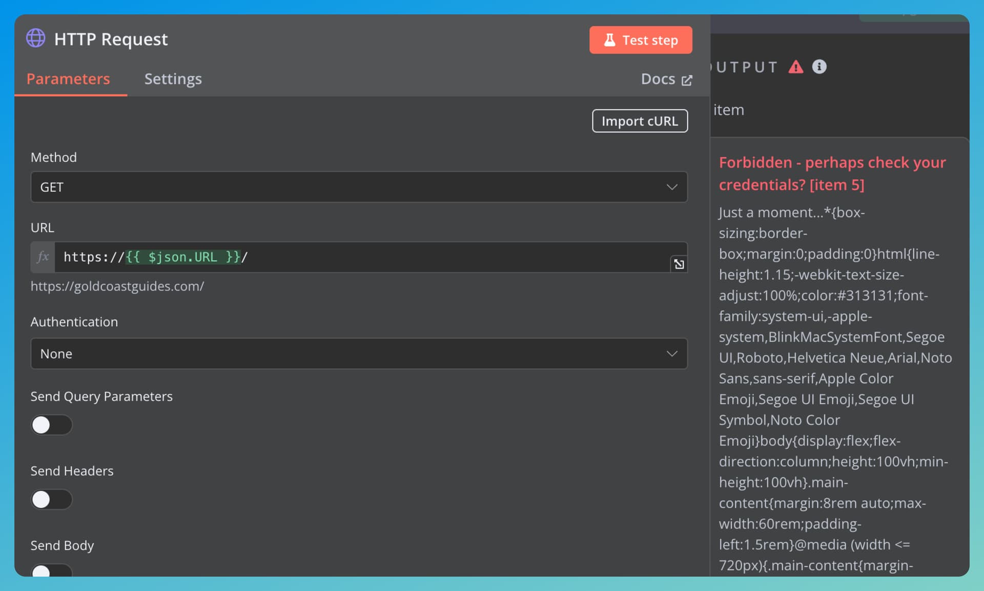

thanks - same error with https
Thanks - yes I can do the same if i put the url in - however once i try use json (see the image I attached)to have the url as a variable (i have a number of url i want to check) it is then that it fails - so something is happening different between the two methods- thanks for your help
What’s inside the sixth URL item? The error is showed for it, but you are showing the result of the first item.
Open the table view and check the url.
