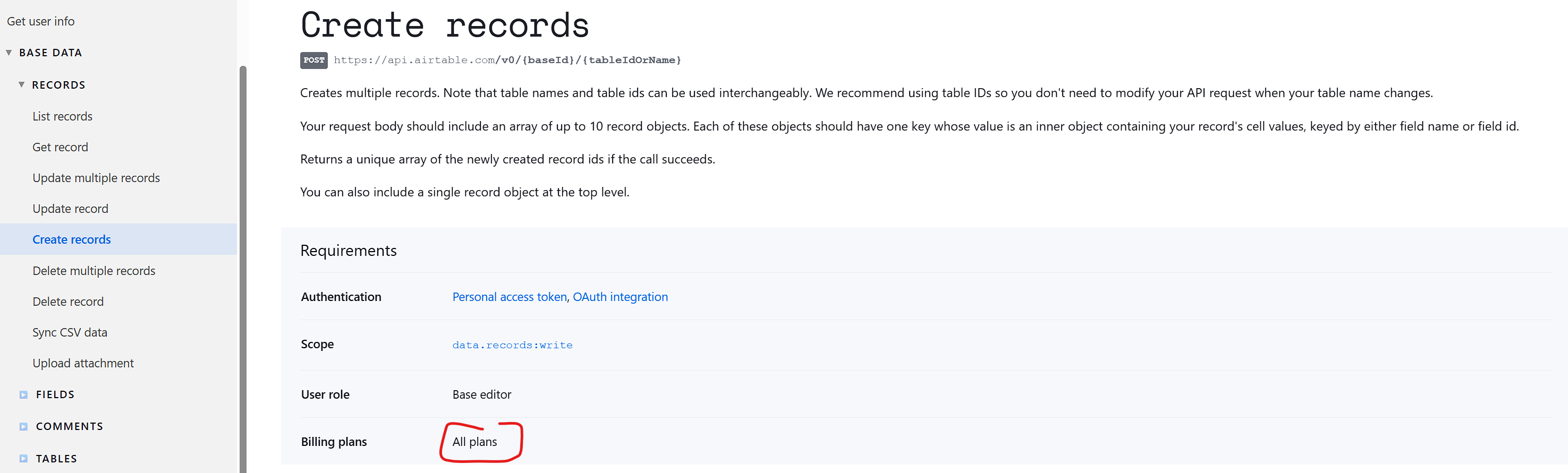

@Zelite The only way to solve this if i purchase the pro plan? It mentions that I should be able to create and update records with any plan.
I have also tried testing the token in n8n to check what permission levels I have in the base and it mentions “create”.
