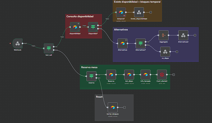

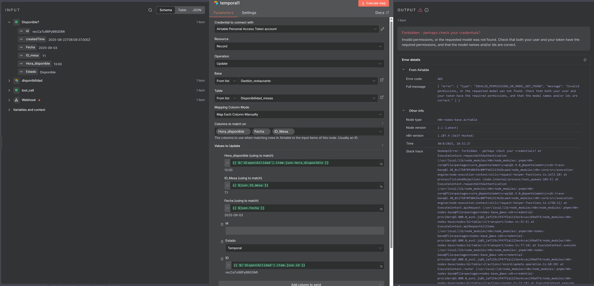

I’m using n8n with a workflow connected to VAPI and Airtable. The problem is that my Airtable Create and Update nodes consistently fail with a 403 – Invalid permissions or credentials error, while the Search nodes work perfectly.

Despite this, the create and update nodes still fail, while search works fine.
How can I successfully connect and allow create and update operations in Airtable through n8n?

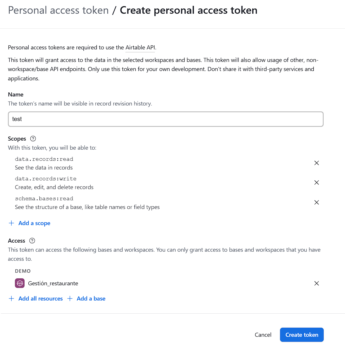

Hey, thanks for your response. I have added the write permissions to the PAT too. I have attached a screenshow below with the selected scopes. Where is the other place I need to grant access in or what could be another issue for the problem?
Thanks for the screenshot @Dexiuzhan It confirms you’ve set up the token correctly with the right scopes.
The Most Likely Cause is the Base Level Access, your token might have write scopes, but if its access level for that specific base is set to “Read” instead of “Write”, you will get the exact 403 error you’re seeing.

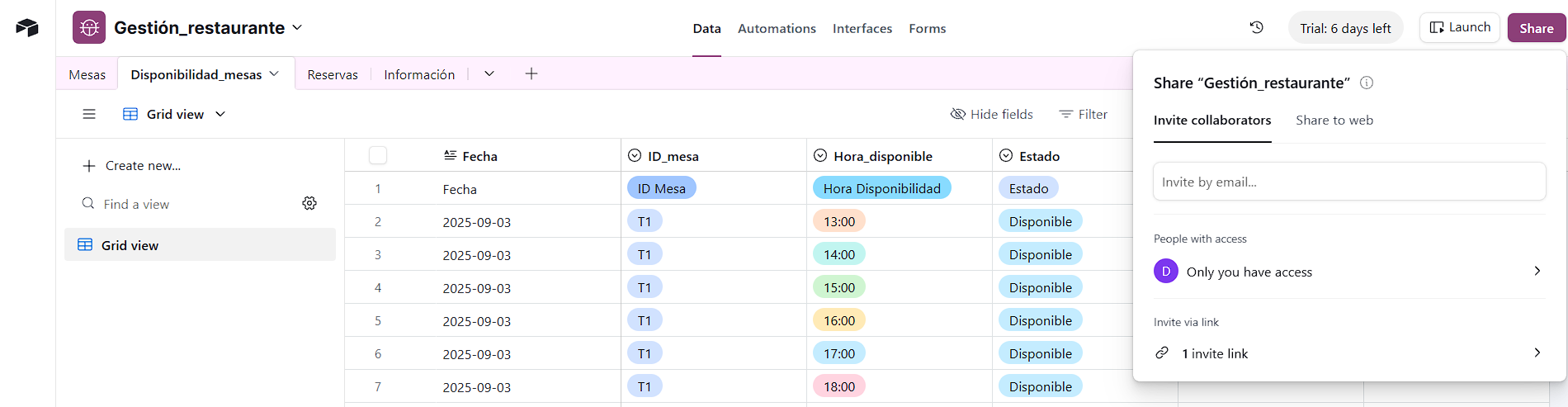

I dont see an option for the tab or section called “Automation & Scripting” or “API & Scripting Access” or “Access for API & Scripting”. I just shows that I can share a link for someone else to access the base.
You are looking at the wrong “Share” menu. The menu you’re in is for sharing the base with people via a link or email, not for managing API token permissions.

There is no dropdown option appearing to change the base to “write”. I have attached a screenshow below.
