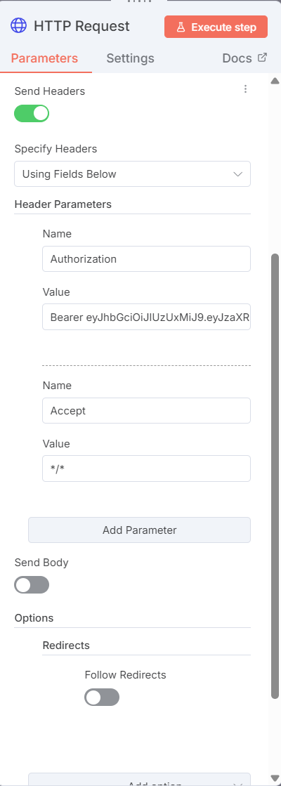

60min after posting the question I found the solution myself :innocent:
To make this work you need to send an “Accept” Header as well - Postman does this automatically but N8N does not. So the working node now looks like this:
Thanks for listening
