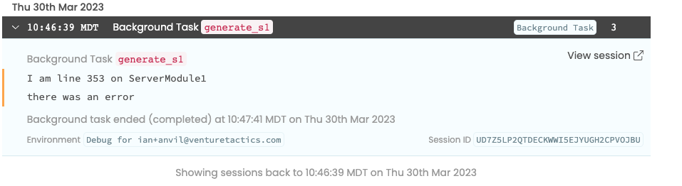

I’m sending a payload to an n8n flow that is taking roughly two and half minutes to run. It completes and the last node’s JSON data should be returned to the caller.
However, I instead am receiving a 504 Gateway Time-out error:
There are no errors in the workflow as far as I can tell, it runs through each step and completes with the expected data being returned. Only, the caller has stopped listening for the response data.
