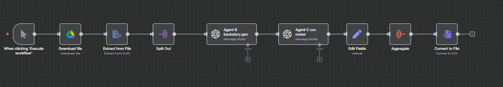

**the workflow on n8n has became unusable.
The service failed to process your request [item 72]**
api.openai.com | 520: Web server is returning an unknown error Web server is returning an unknown error Error code 520 Visit cloudflare.com for more information. 2025-09-24 13:57:06 UTC You Browser Working Frankfurt Cloudflare Working api.openai.com Host Error What happened?

This is really annoying, it has cost us $60 + in openAI api cost already that just went straight down the drain
Can you share your workflow? Also please answer:

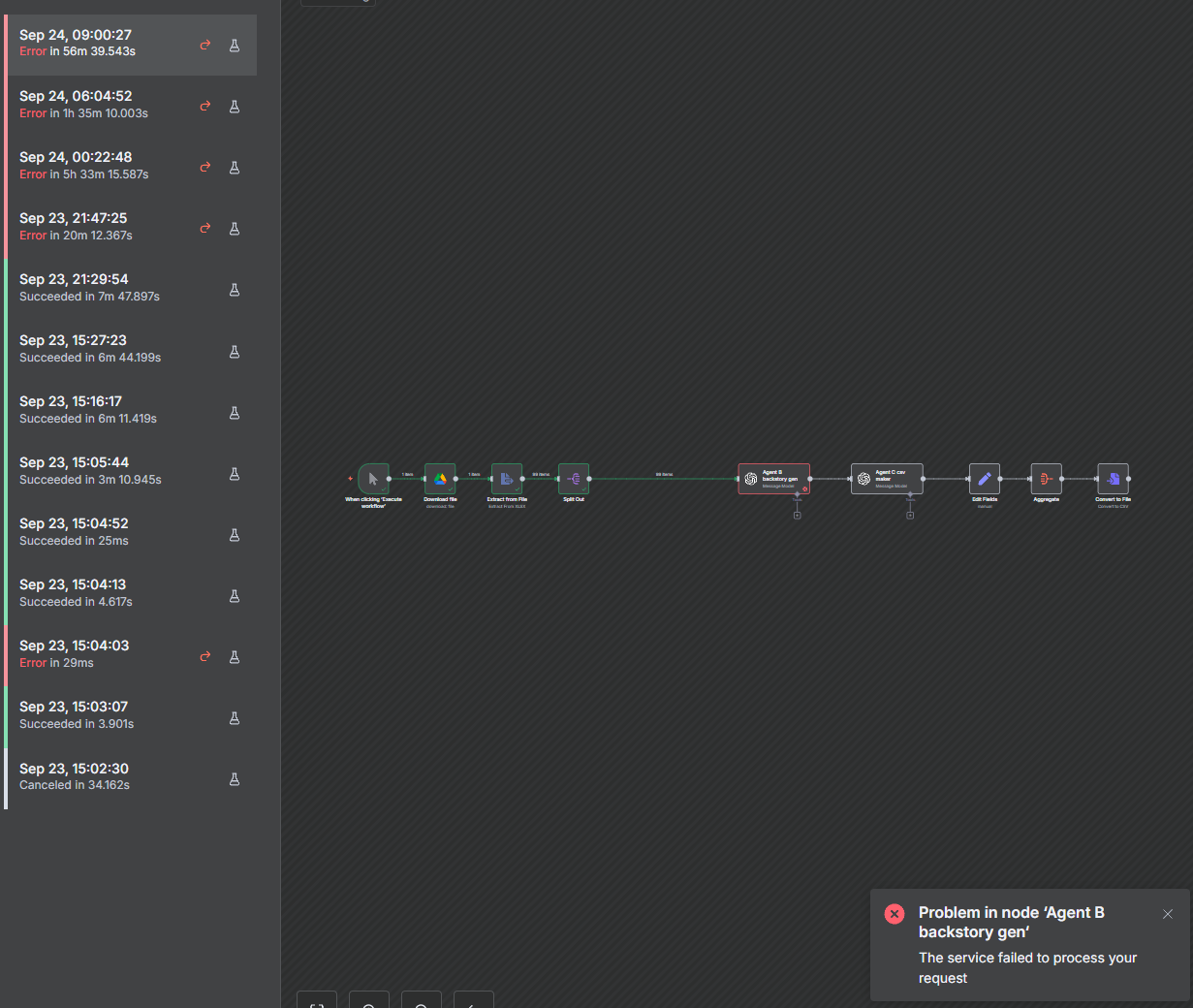

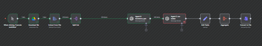

specify the node that throws the error or where you spot it
Both openai message a model node are getting this error now.
  • is it the only workflow affected?
    Yeah it is the only workflow affected, but similar workflow has ran previously
  • did it work before?
    In small batch test it worked, but the full scale 380ish records batch process has failed on both node

Thank you. My thesis is that you are sending too many items and end up rate-limited. You have pretty much confirmed it by running smaller tests and failing at the large ones.
Please go through OpenAI’s rate limit docs, and validate if you are hitting them in some way. Depending on the specifics, you can then stagger your processing to be slower, or increase limits if possible, etc.
