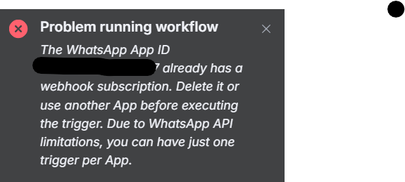

i have a proplem with whatsapp api it says that ther is another trigger running on the same app i tried to delete the facebook app and created another one and connected the trigger with the new app but the error still
Hi,
My guess atm, is that you have more than one whatsapp trigger node in n8n? Can you check other workflows as this could be why.

Hi I think I know the issue.
Try to run an HTTP node with the configuration below. Just replace the orange parts with your specific values. And then import with the cURL import button. It will return your active webhook. I think n8n doesn’t delete webhooks once they have been created so you need to do it yourself.
curl 'https://graph.facebook.com/<API_VERSION>/<WHATSAPP_BUSINESS_ACCOUNT_ID>/subscribed_apps' \
-H 'Authorization: Bearer <ACCESS_TOKEN>'
You can then send another http request to delete the one. And then make a new trigger.
Read more about this here: WhatsApp Business Accounts - Webhooks from Meta - Documentation - Meta for Developers

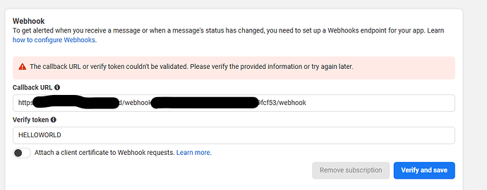

it gives me the error in the following image + Whats the verify token ?
OK I think I found the culprit. You have to make a new credential. The old one is n8n should be deleted and recreated.
