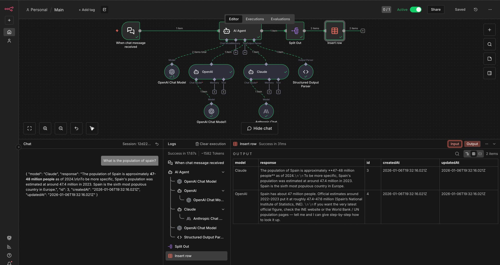

Are you able to give us more context of what you’re referring to? Are you talking about LLM Models when using an AI Agent?
If yes to my above question, then you could probably use sub-agents with a specialised main orchestrator agent calling sub agents, each using a different model. Since we use a structured parser, you can then just push the results into your data table

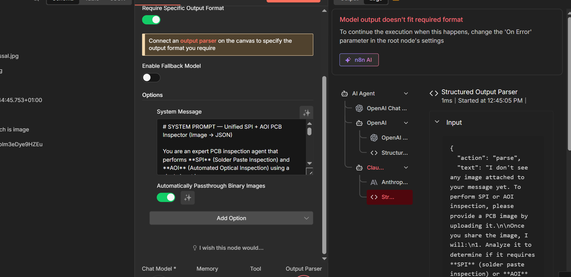

but i have a proplem that my in put is an image

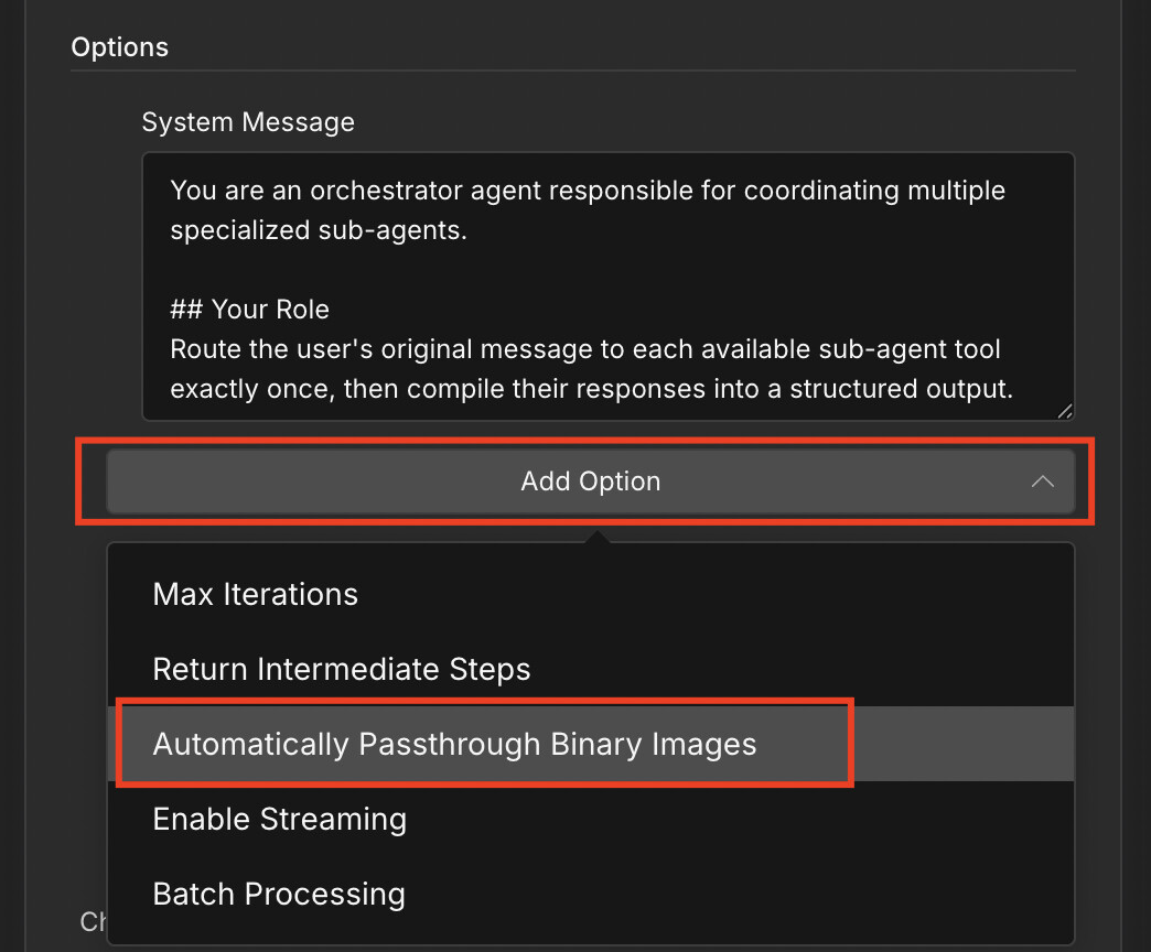

Under the additional options for the main as well as each of the sub agents, set the passthrough binary image option
Although I think this is enabled by default

i set the passthrough binary image , but it doesnot fed through the models
