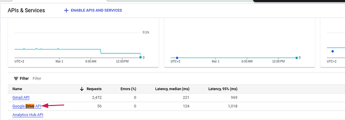

403 Forbidden usually means that you are authenticated but you don’t have permissions to perform the specific action.
If you used the same OAuth Application for google Calendar and it worked you should double-check if you’ve enabled the google drive API from gcp:

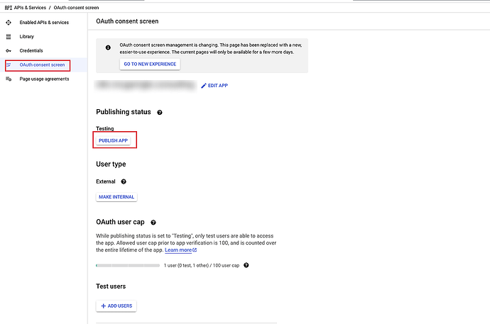

You likely need to go here:
and then on that page (ignore the publish app button, I got the screenshot from somewhere else), go to the bottom where you can see “Test users”. You might have to either add your gmail address as a test user or if that doesn’t work click on publish app button.

This is what made it work for me!
I needed to add myself as a tester to the project.
Thank you!

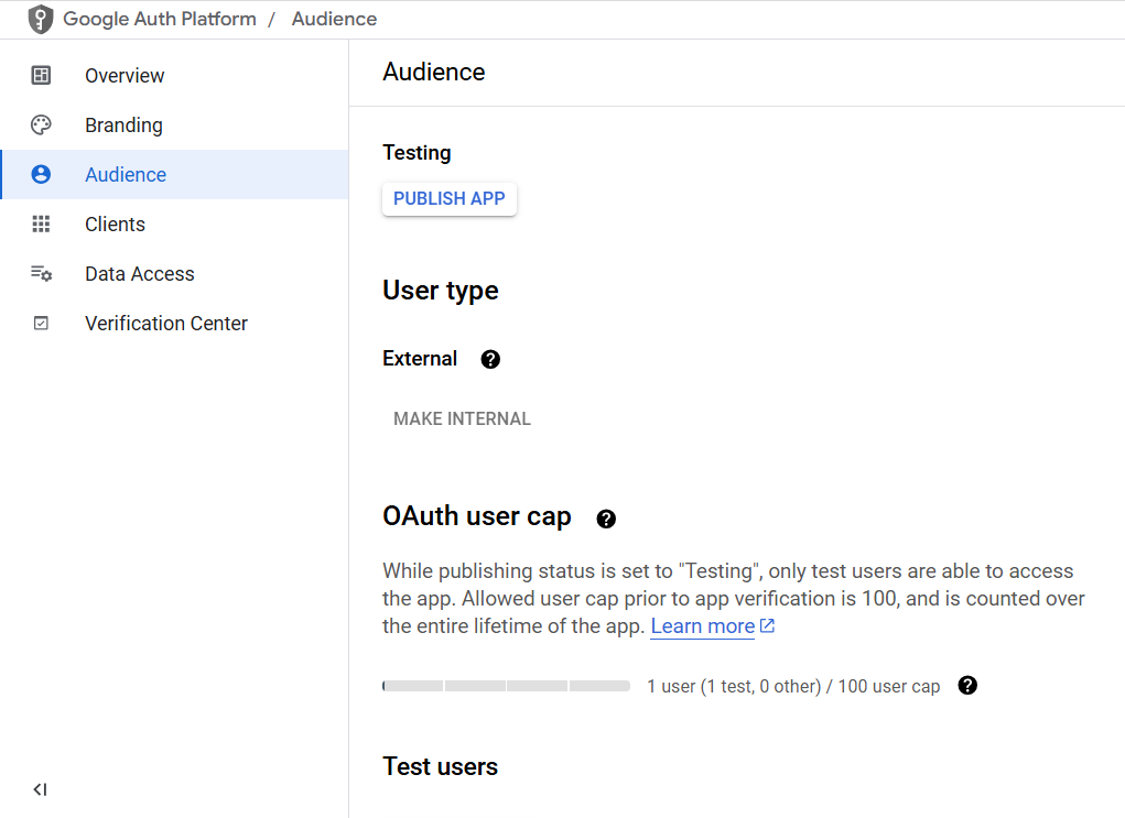

Since @hrishikesh shared the screenshot, Google updated the screen, and now Publishing Status and Test Users appear under Audience.
