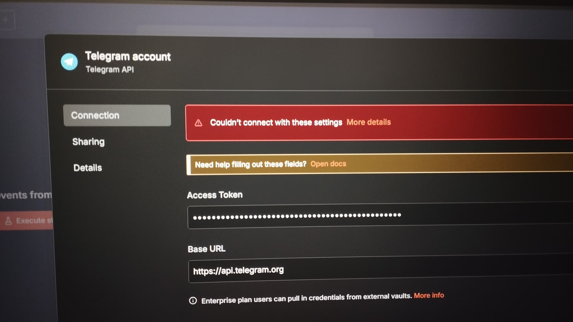

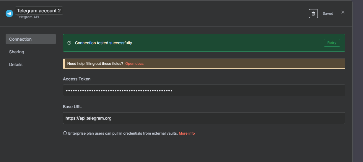

hi ive bad problem with this telegram trigger
i use npx and ngrok for n8n and my url on n8n server host is https but when the telegram trigger dosnt connect with token to my bot
telegram trigger dosnt connect to my bot with token it show me this error
pls help me idk that what should i do !!:folded_hands:
Are there any details under “More details”?
Hi! I faced the exact same issue and managed to solve it completely. The problem is usually related to network connectivity between your n8n instance and Telegram’s API servers. Here’s a step-by-step solution:

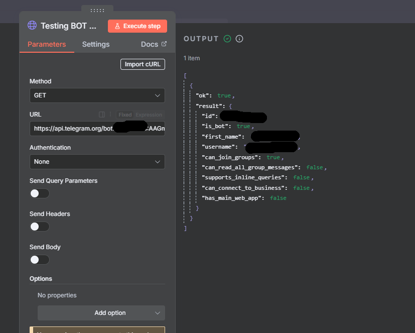

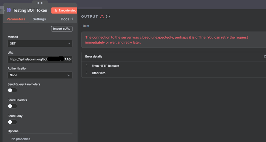

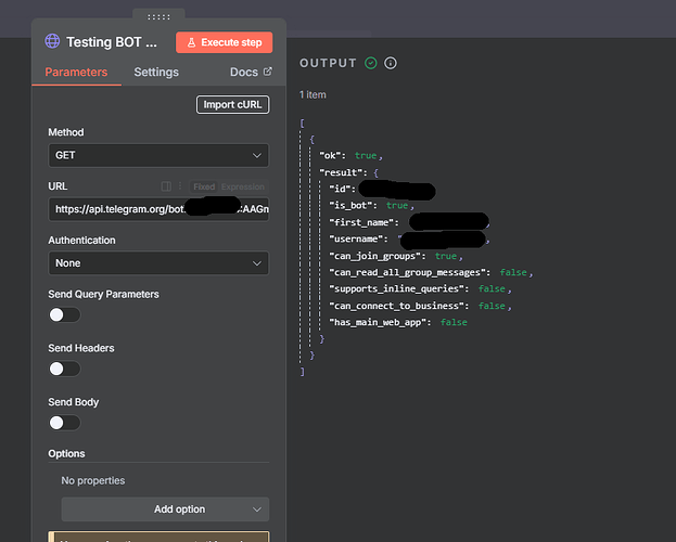

Step 1: Test Your Bot Token Before anything else, verify your bot token works:
  • Create a simple HTTP Request node in n8n
  • Method: GET
  • URL: https://api.telegram.org/bot[YOUR_BOT_TOKEN]/getMe
  • Execute it
If it fails like this with ENOTFOUND api.telegram.org or connection timeout, the issue is network connectivity, not your bot token.

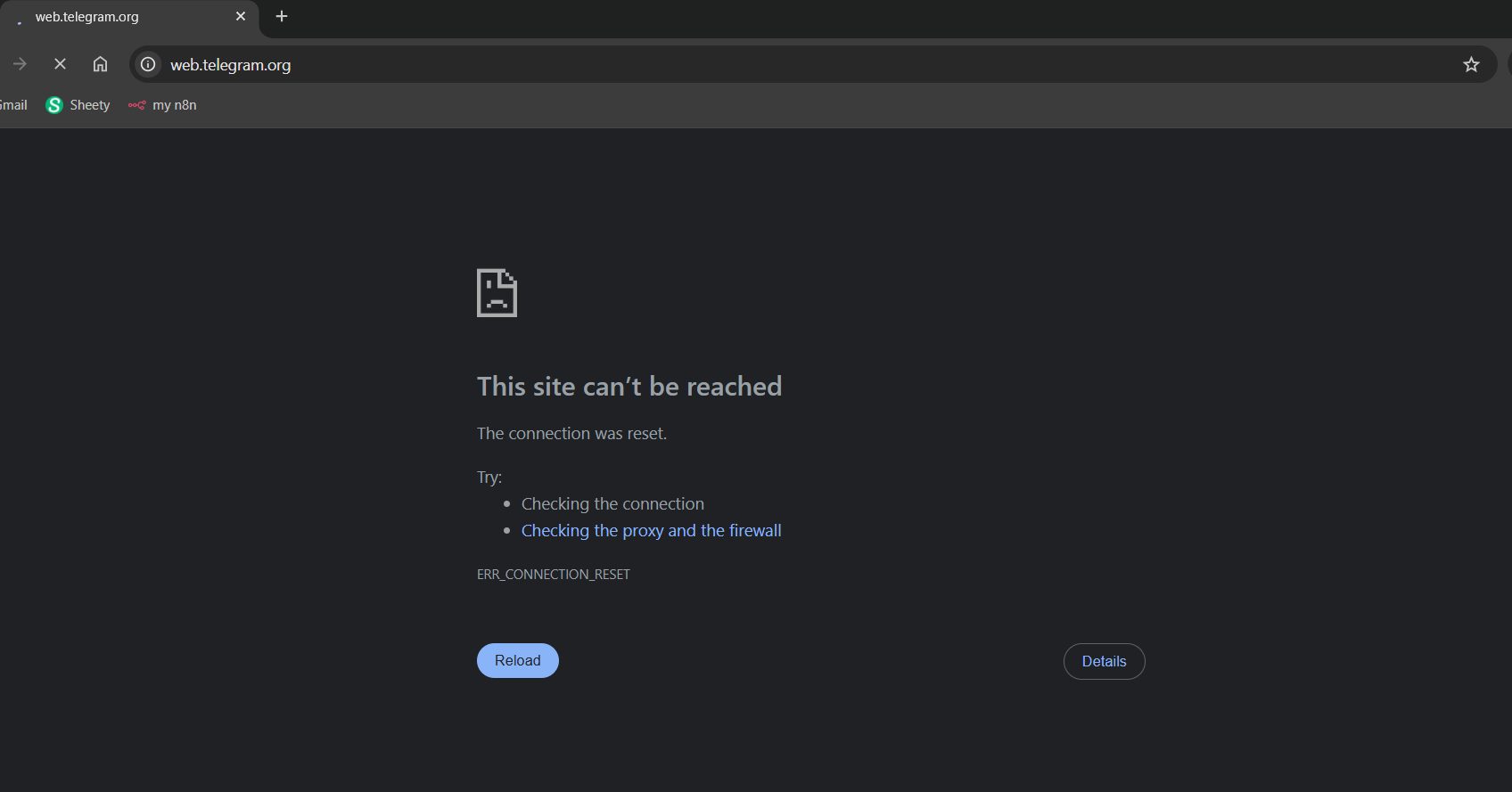

Common Cause: ISP Blocking Telegram (in my case too)
Many ISPs block Telegram services. Quick test:
Solution: Configure n8n to Work with VPN
Step 1: Set Up VPN
  • Install a reliable VPN (I recommend ProtonVPN - it’s secure and has a free tier)
  • Connect to VPN and verify Telegram web works

Step 3: Test Telegram API Connection After restarting n8n with VPN:
  • Go back to your HTTP Request node
  • Execute the getMe API call again
  • You should now see your bot information

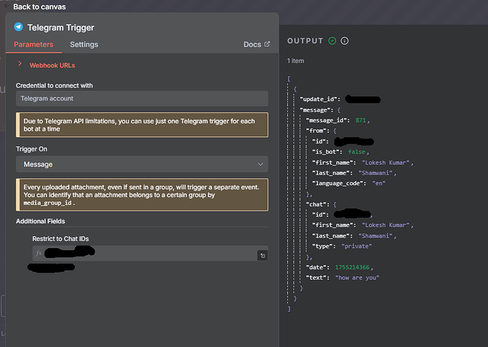

Step 4: Configure Telegram Trigger
Now your Telegram Trigger should work:
  1. Add Telegram Trigger node
  2. Create new credentials:
    • Access Token: Your full bot token (including the colon)
  1. Save and activate the workflow

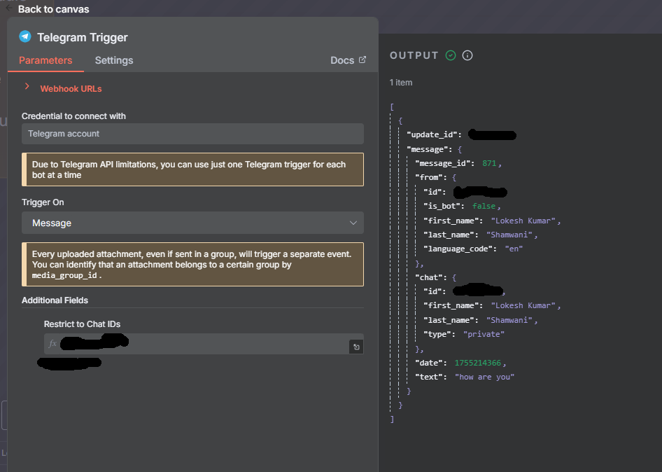

Expected Result:
After following these steps, your Telegram Trigger should show:
  • :white_check_mark: Connected status
  • No error messages
  • Ready to receive webhook calls
