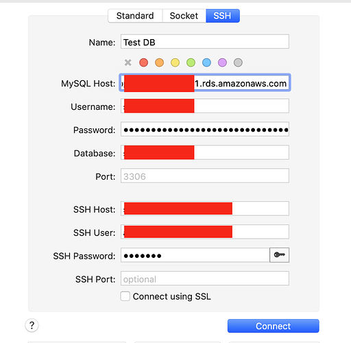

This is how I access it through Sequel Pro

Thanks Jan, fully understandable. I was most curious about the Mysql node on n8n. Perhaps the issue is there on how it forwards its requests and perhaps one could add the SSH tunneling in like Sequel pro to make it easier.
