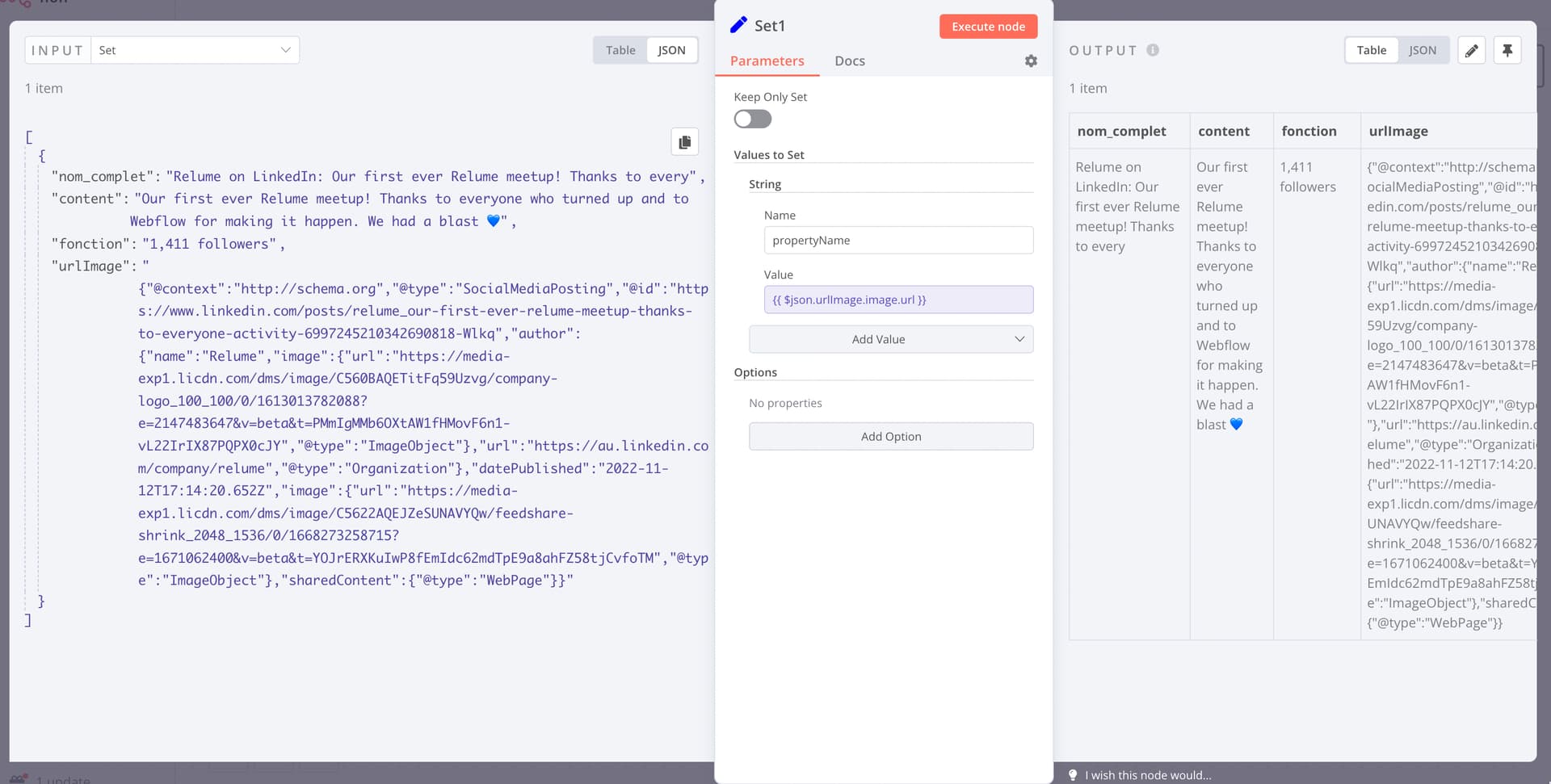

Here is the object if you have an idea…
Thanks a lot!
If you look at the way the data is being presented in the urlImage
field of the previous node, it’s being output as a string rather than JSON.
If you want to access the keys inside of that JSON, then it needs to be output as a JSON object.
Hint: Did you mistakenly insert a JSON.stringify somewhere?

That’s why I thought Joel.
No there is not json.stringify… Before this node, I’ve got an Extract HTML Node.
How to convert this string in JSON? I’ve tried JSON.stringify, but I’m not sure how to write it… Do you have an idea to help me please?
Thanks
jan
November 12, 2022, 10:44pm
6
Ah great find @joeldeteves ! Did not see that it is a string.
In this case @MB1 , you need JSON.parse
which does the exact opposite of JSON.stringify
{{ JSON.parse($json.urlImage).image.url }}

This so great Jan!
Thanks a lot for your help. It’s working fine!
