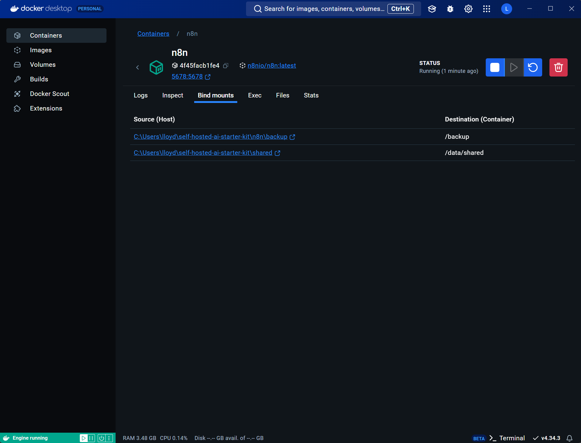

I am using docker UI and do not see the folder mounted
None as I assume the folder isn’t mounted

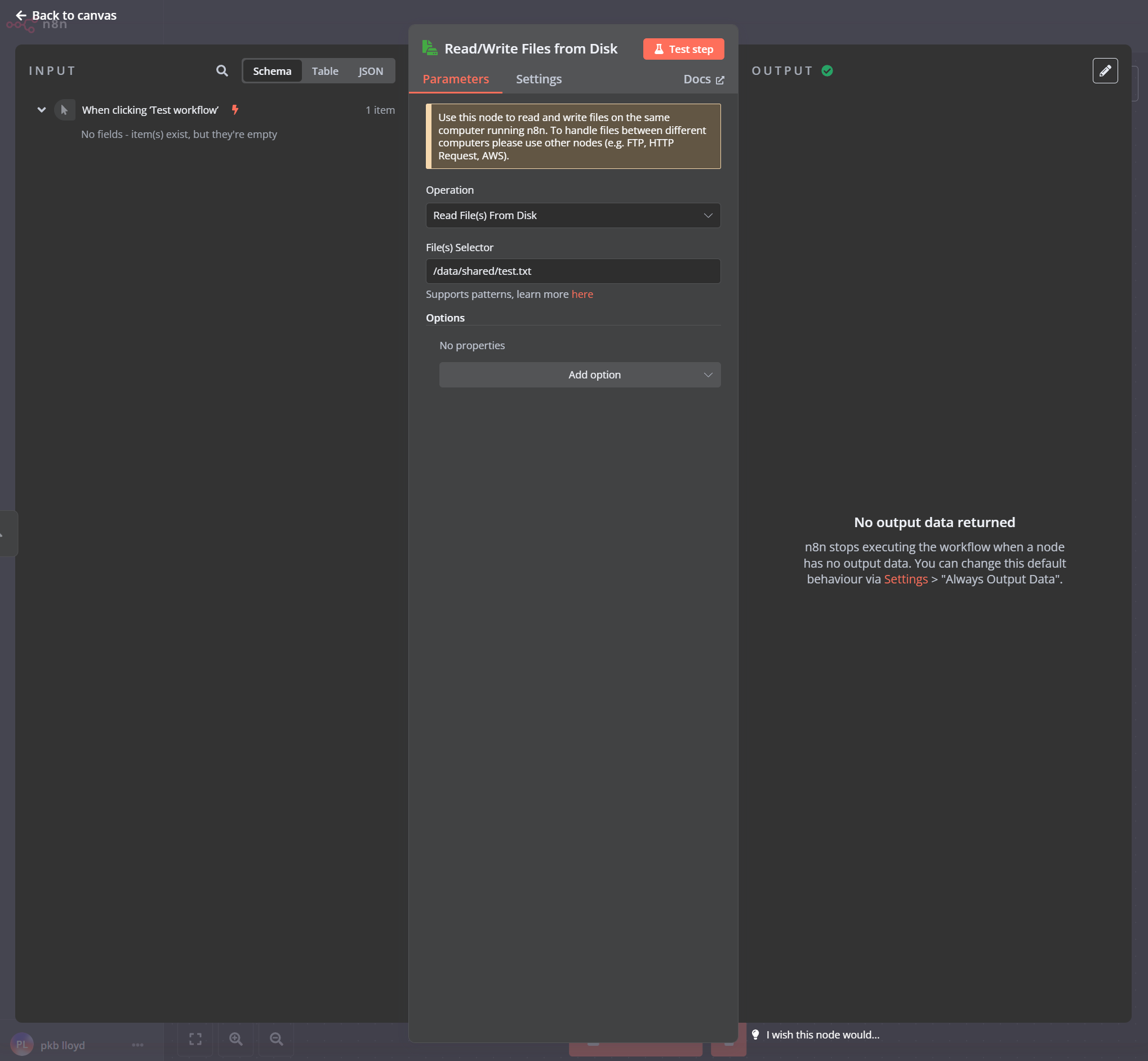

Although tbf I have just tried to pick the file from the default shared folder and that isn’t working either
I must be doing something wrong.

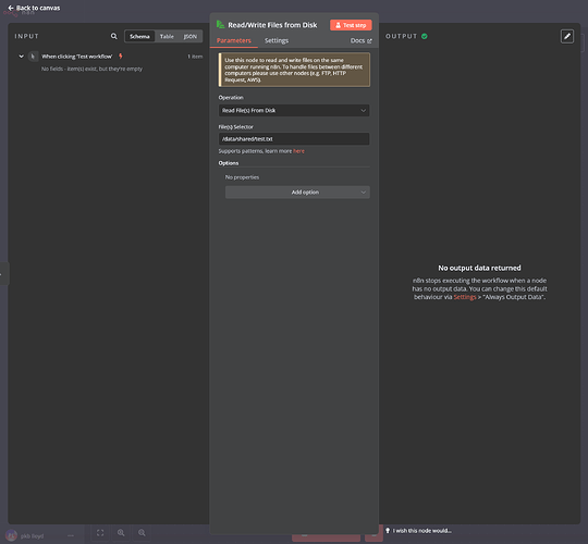

What was the error? Permission denied or something else?
Absolutely nothing. The node returns as no data returned but no actual error.
Docker doiesn’t show the folder as mounted either.

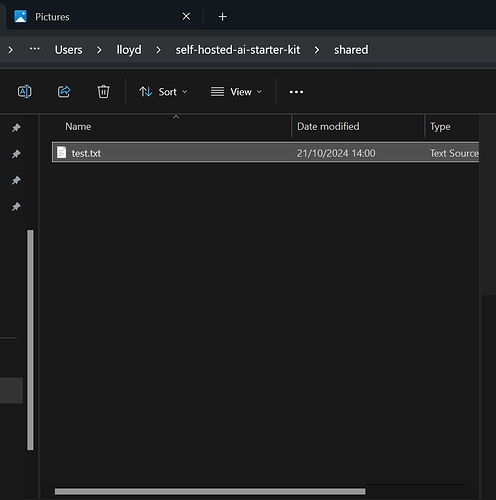

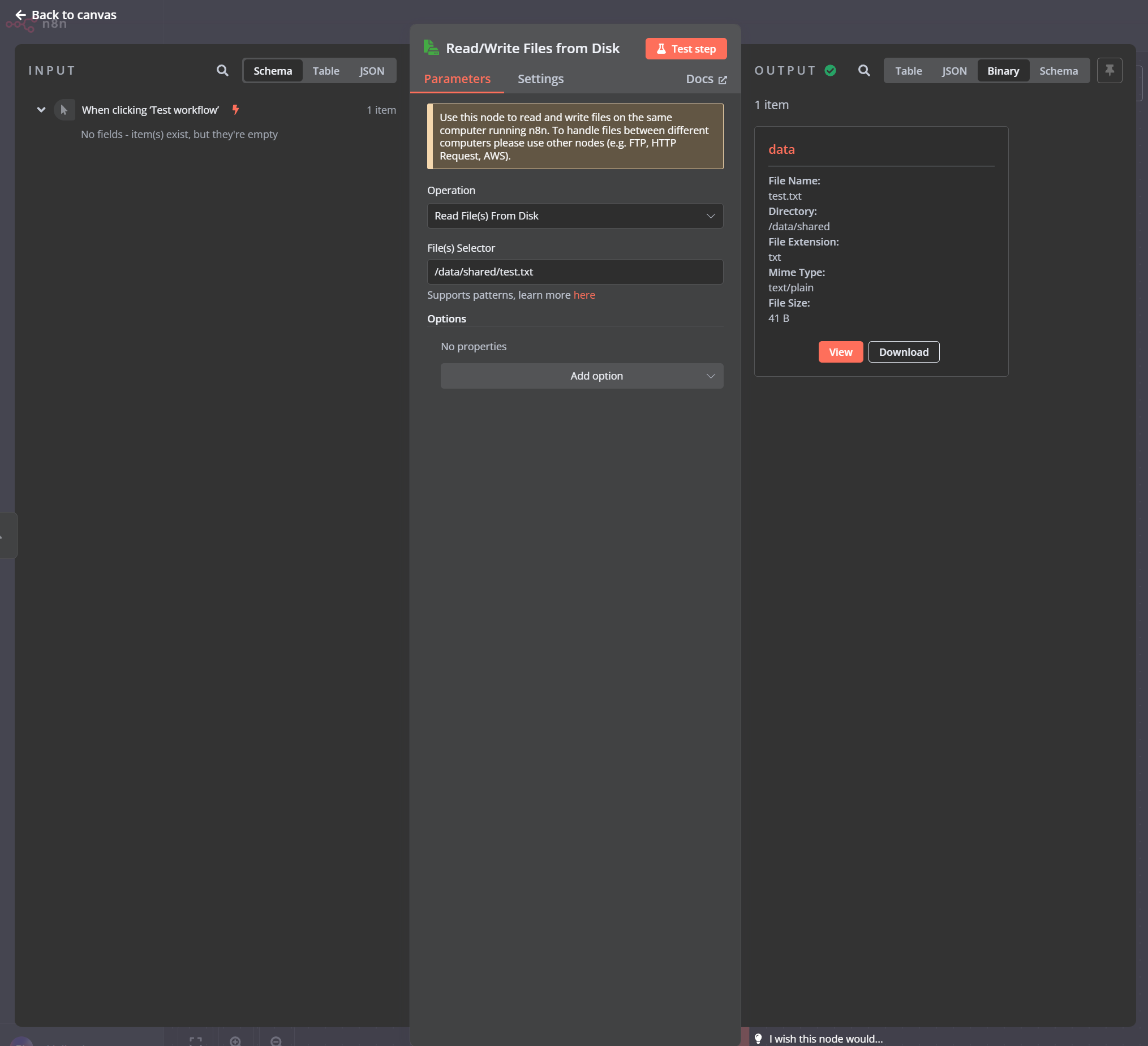

Ok, so the node is working for the shared folder now.
The file was named incorrectly (windows added the .txt even though it was already there. Yay windows!!)
So the issue is specifically mapping the folder to the docker setup.
Maybe one of the listed below will work
- "C:/Users/lloyd/Documents/Main Vault/":/data/obsidian
- "/c/Users/lloyd/Documents/Main Vault":/data/obsidian
- "/c/Users/lloyd/Documents/Main Vault/":/data/obsidian
- "//c/Users/lloyd/Documents/Main Vault":/data/obsidian
- "//c/Users/lloyd/Documents/Main Vault/":/data/obsidian
I don’t have a docker for windows right now, so can’t test
Thank you for all your help. All my research would suggest it is very difficult to bind a folder to docker in windows. Shocker I know. I have gone the other way round and put the Obsidian vault in the shared folder and redirected all the things for Obsidian as that was easier. Thanks again though.
