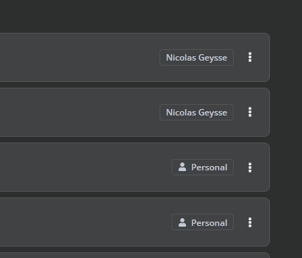

I also see that my new credentials, but also my workflows created on the new instance are now tagged to my name, and not “Personal” as it used to be.
That leads to an impossibility of sharing or using the credentials , and surely problems while executing sub workflows that does not belong to personnal to be executed.
