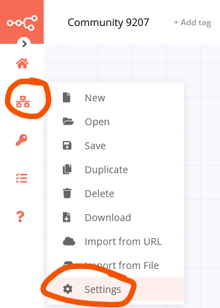

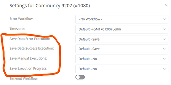

On the actual issue, I suspect there might be a misunderstanding of how active workflows behave. When activating a workflow, you wouldn’t see the execution progress in the canvas (in other words, data sent to your production endpoint would not show up by straight away). You can, however, configure your workflow to save execution data in the workflow settings:

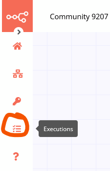

Past execution data will then be available through the Executions list and can be viewed by clicking the folder icon next to each execution:

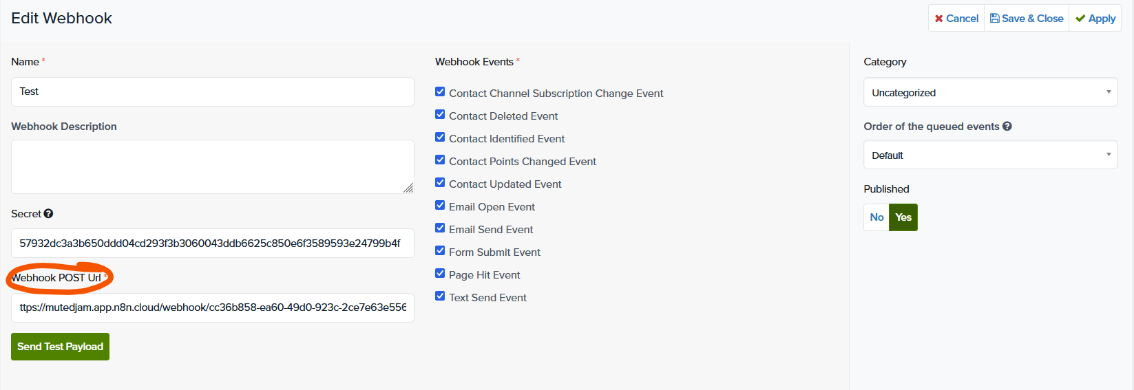

I tried reproducing this problem using my own Mautic account and n8n production webhook URL:
The request arrives as expected in my n8n instance:

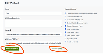

Mautic also logs a success in this case (I assume this is where you saw the 404 error?):

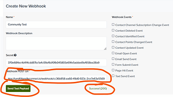

I can also submit a Mautic payload to your URL successfully:

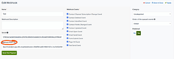

So this very much looks like a problem with the specific Mautic webhook you have configured. Could you double-check the URL field in your webhook settings and make sure it’s an exact match of your production URL (no trailing spaces or weird characters anywhere)?
