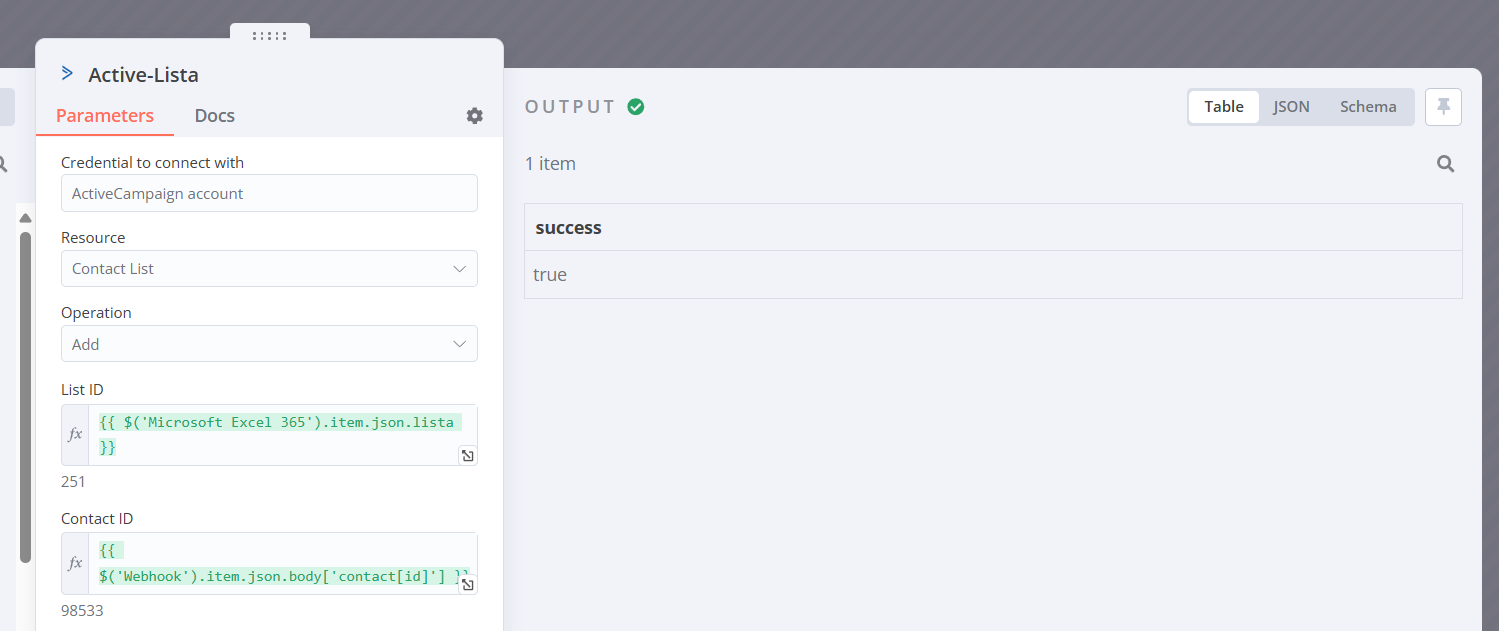

I’m trying to create a simple node that, upon a contact arriving in a list, performs a basic check on their origin and directs them to a specific list. The workflow runs correctly, but the contact is not added to the list. Any ideas on what could be causing this?

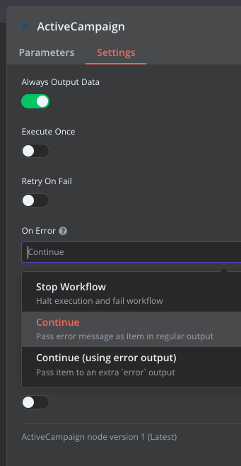

Also, you could change the error output settings of the node to see what’s it is returning.
Let me know what your findings are! ![]()
Hi, @ria ![]()
Thank you very much for your help, I applied the settings you suggested, but it did not work.
This seems to be a very simple process to apply, but for some unknown reason I don’t know why it’s not working.
The curious thing is that in a previous step I even add information to a custom contact field and it works correctly.

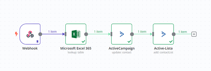

Here is an image of the entire flow.
