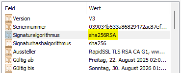

Certificate:
Data:
Version: 3 (0x2)
Serial Number: 039034b533a86829472ac87eff3d2de1
Signature Algorithm: sha256RSA
Issuer: C=US, O=DigiCert Inc, CN=RapidSSL TLS RSA CA G1
Validity
Not Before: Aug 22 02:00:00 2025 GMT
Not After : Aug 30 01:59:59 2026 GMT
Subject: CN=*.mydomain.de
X509v3 extensions:
X509v3 Subject Alternative Name:
DNS:*
.mydomain.de, DNS:mydomain.de
Of course the mydomain is other than here typed, in my real config the real domain name is in.
The “Signature Algorithm” is per Certificate “sha256”. I’ve tried also with “sha256WithRSAEncryption” (which means, other than the certificate itself its showing me …
… maybe the keyword must be typed like this, dont know.
But every time i reboot the machine (dont know how to come up docker with the new configuration), its not working. No matter if sha256RSA or sha256WithRSAEncryption.
Or must there typed in a command that the new config is going to affect?! Thats why I’m rebooting all the time :grin:
Btw, i find it also strange to define the starting date of the certificate, and the encryption? I would assume the config reads the certificate and know all those parameter and is using them accordingly. Dont understand why i need manual configuration (eg. the exact starting time or ending time for the certificate) for this. But of course, you know better that it must be.

Certificate:
    Data:
        Version: 3 (0x2)
        Signature Algorithm: sha256WithRSAEncryption
        Validity
        X509v3 extensions:
                DNS:*.mydomain.de, DNS:mydomain.de

Or if i use the keyword “sha256WithRSAEncryption” (which came from your example), or using “sha256RSA” like its real named in my cert … (only the Certificate: Part):
    Certificate:
        Data:
            Version: 3 (0x2)
            Validity
            X509v3 extensions:
Seemed to be a hard Job, to get that to work. And in the Docker logs i cant find any helpful Information, which points me in the right direction.
